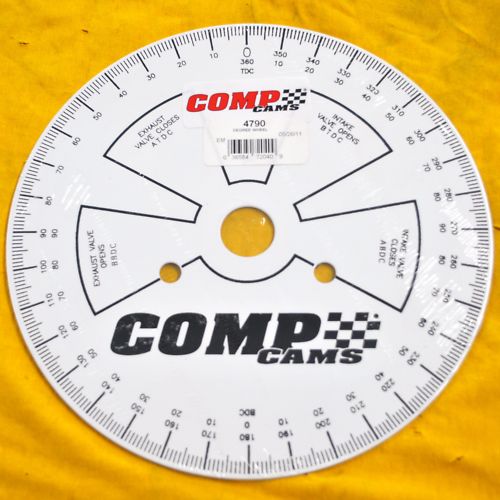

Seems this may have been useful earlier?
And+1 for knowing exactly what the injectors are. A tune without the correct info is just a guess, and more opportunity for error.
