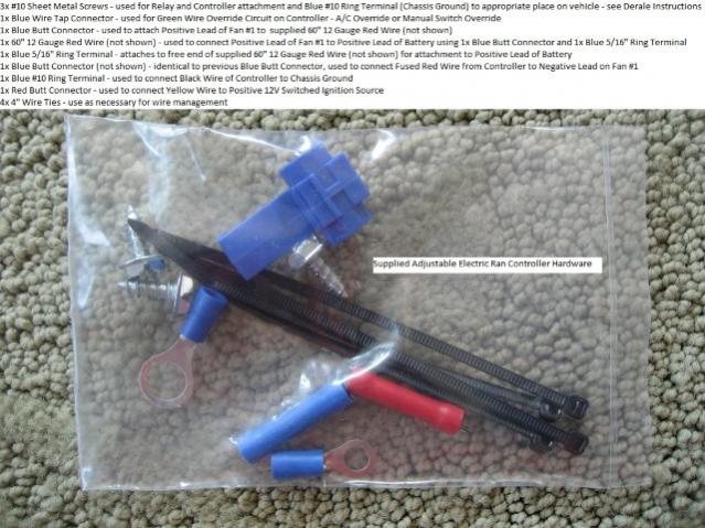

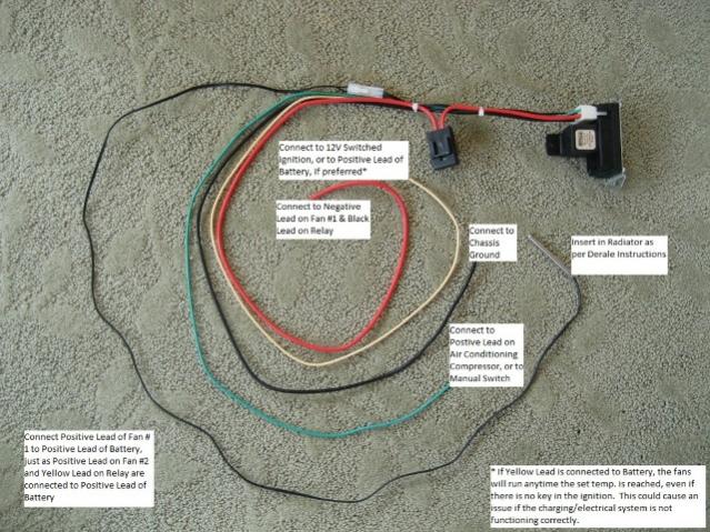

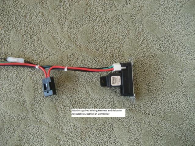

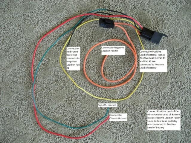

Bought a Perma-Cool CoolPak (19520) way back when. Towed a trailer from Illinois to Texas, not knowing that the inline fuse to the battery was corroded. Got to Oklahoma for a fuel fillup, noticed that the fans were not running. Before I left the station I jostled the fuse wire, the fans kicked on. Somehow I rationalized that the system would work now, no need to eliminate the fuse or replace the fuse reciever itself. Wanting to save time, I drove the rest of the way, windows down, heater on full blast (did I mention it was August) to keep the engine temp down. Long story short, got there fine, fans were functional, but the control system was dead. Since then I have been turning the fans on through a switch I wired in the cab. I got tired of it. I went and bought a Derale Adjustable Electric Fan Controller (16759) and an Electric Fan Relay Harness (16763). Attached are the wiring instructions for the controller and the relay, and my hand drawn pretty picture of how to wire them together. Hardest part was taping into the wiper motor system for the 12V switched ignition source, but that would take only 10 minutes if I had to do it again. Fans were Perma-Cool 2950cfm 16" fans, and since they are somewhat out of business, I went with the Derale brains.
