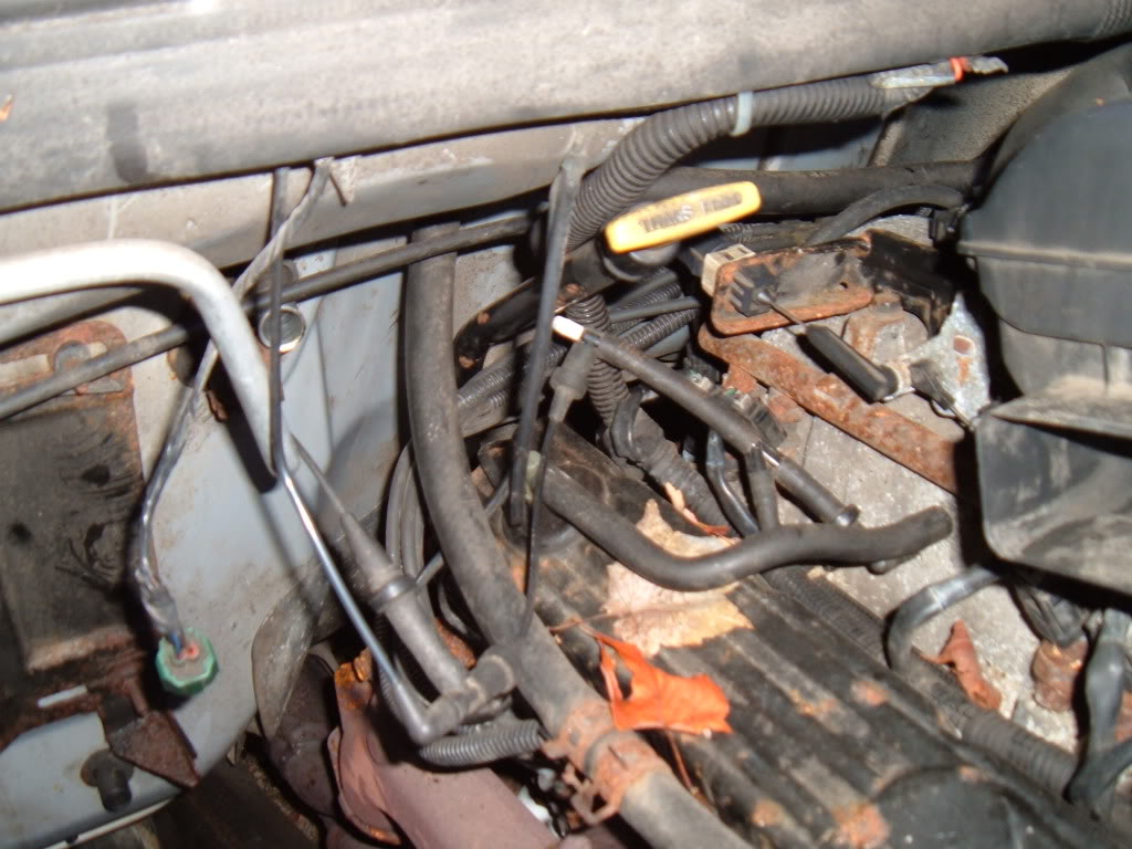

Anyone got a pic of this drain tube location?
The tube is located under/behind the accumulator/dryer bracket. Which is located just to the right of the PCM .

Its on the bottom left of this pic.
