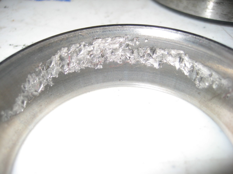

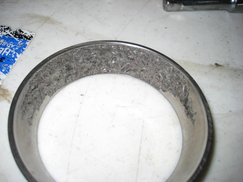

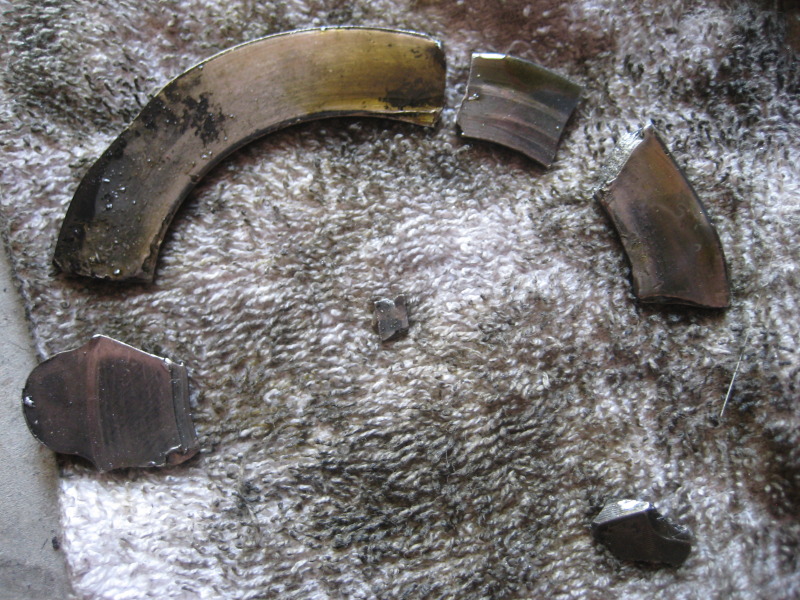

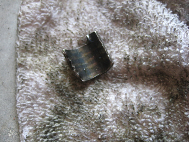

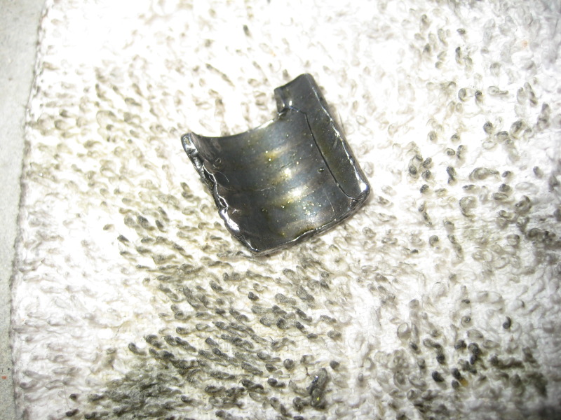

Update-
I got everything tore apart and just waiting for parts to arrive in the mail. I ordered the bearings, races, and new spicer clutch packs. Also some other odds and ends, nuts bolts etc.
Here is the junk found during disassembly. One of the bearing cages was broken and two of the rollers were out, forgot to take a pic of that before it went in the dumpster. So far I'm only out about $200 and part of that was a inch pound torque wrench I bought to set pinion pre load

Old Aug 3, 2012 | 11:46 PM
QuadCabLuv's Avatar
QuadCabLuv
Posts: 1,585
Good job lol. That thing has seen its better days. When you get done you will be glad of the outcome.
