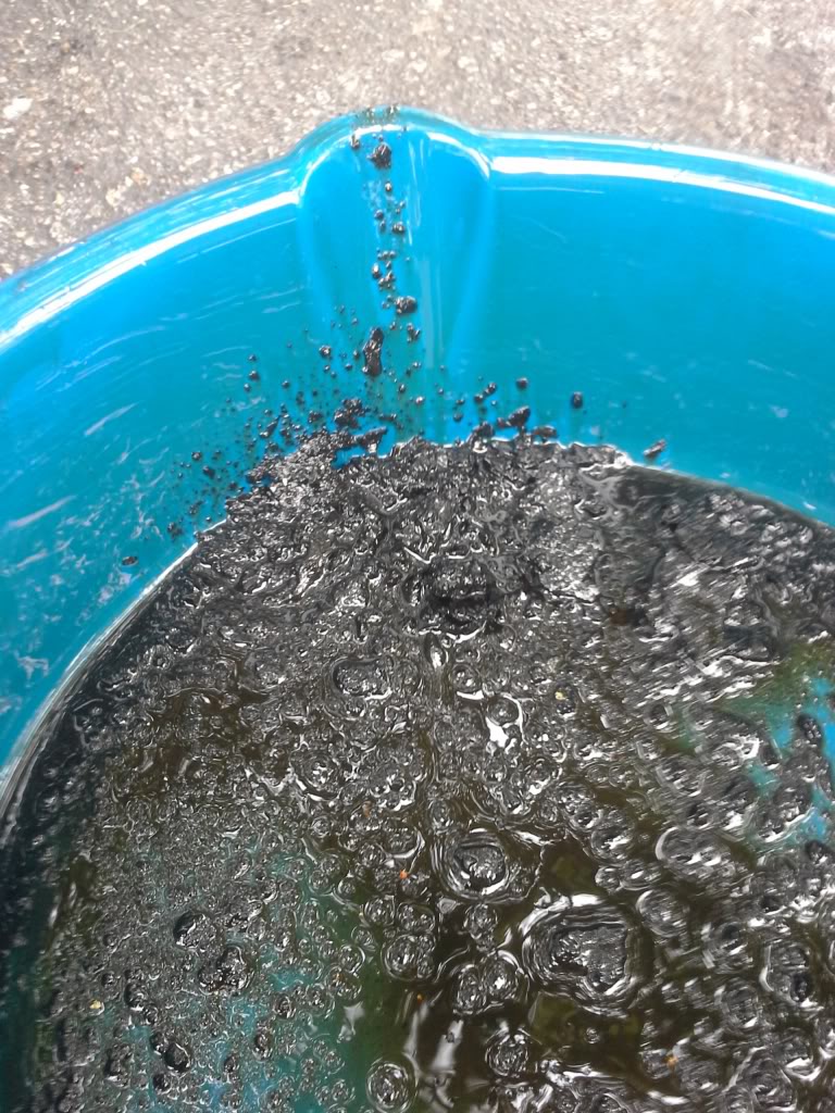

The oil pan was full of junk so I scraped all of that out and cleaned it up real good...

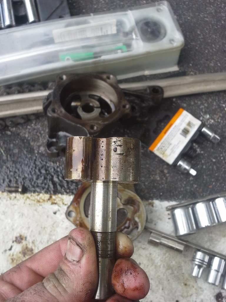

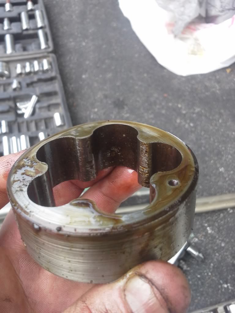

The oil pump didn't seem too bad but there were quite a few gouges from metal shavings going through it...

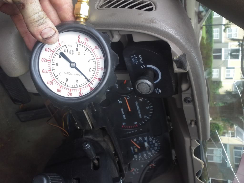

I still had the manual pressure gauge installed on the engine so I fired it up and this what happened...

So do I just need to use heavier weight oil for the engine to stay safe?
What else could be causing the low oil pressure with the lighter weight oil?

I hope you bought a High volume pump. That is the only thing that will give you more time. That pump looks pretty bad to me. those shavings are not good. Those came off of your bottom end somewhere and ended up in the oil pan, where it was then sucked up into the pump. I would start planning on rebuilding the bottom end. Should you need a HV pump I happen to have a brand new one made by Millen that I would sell you for $30 shipped.

Does look like bad news, as a stop gap measure a high volume pump with heavier weight oil will buy you some time but it looks like a bottom end rebuild sooner rather than later. So QuadCabLuv you were right...me and my glass half full attitude. You've heard the saying, "Hope for the best but plan for the worst", well with me it's hope for the best and don't plan at all. lol
