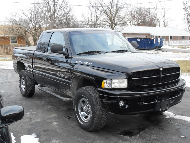

stock 285/75 on more level ground lol

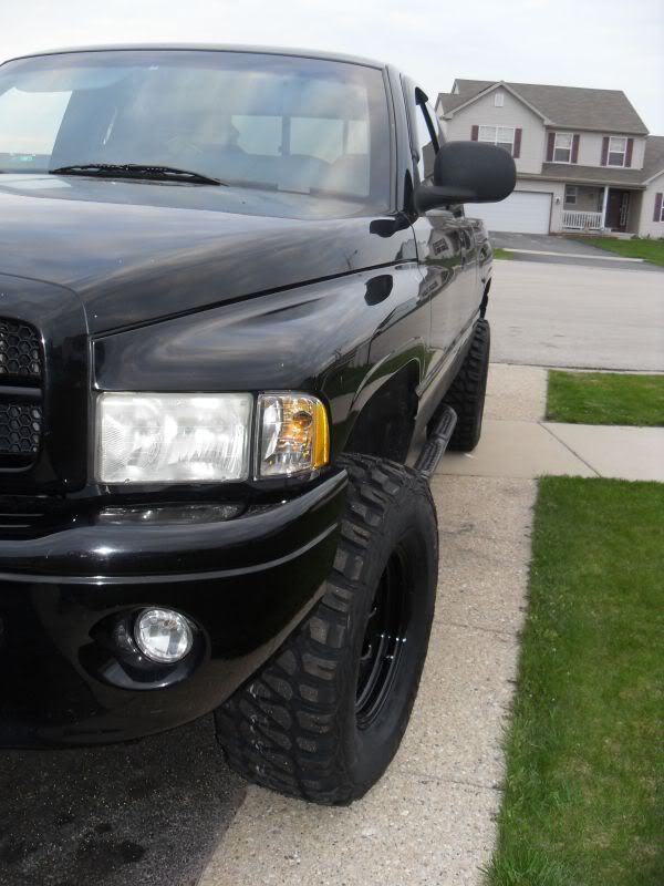

side pic of 305/70s when i first got them
and no rubbing even with tire pushed up in wheel well

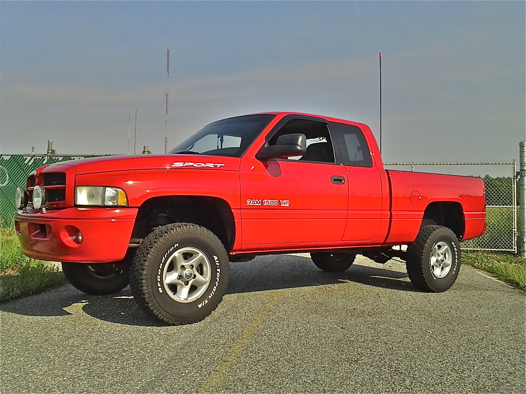

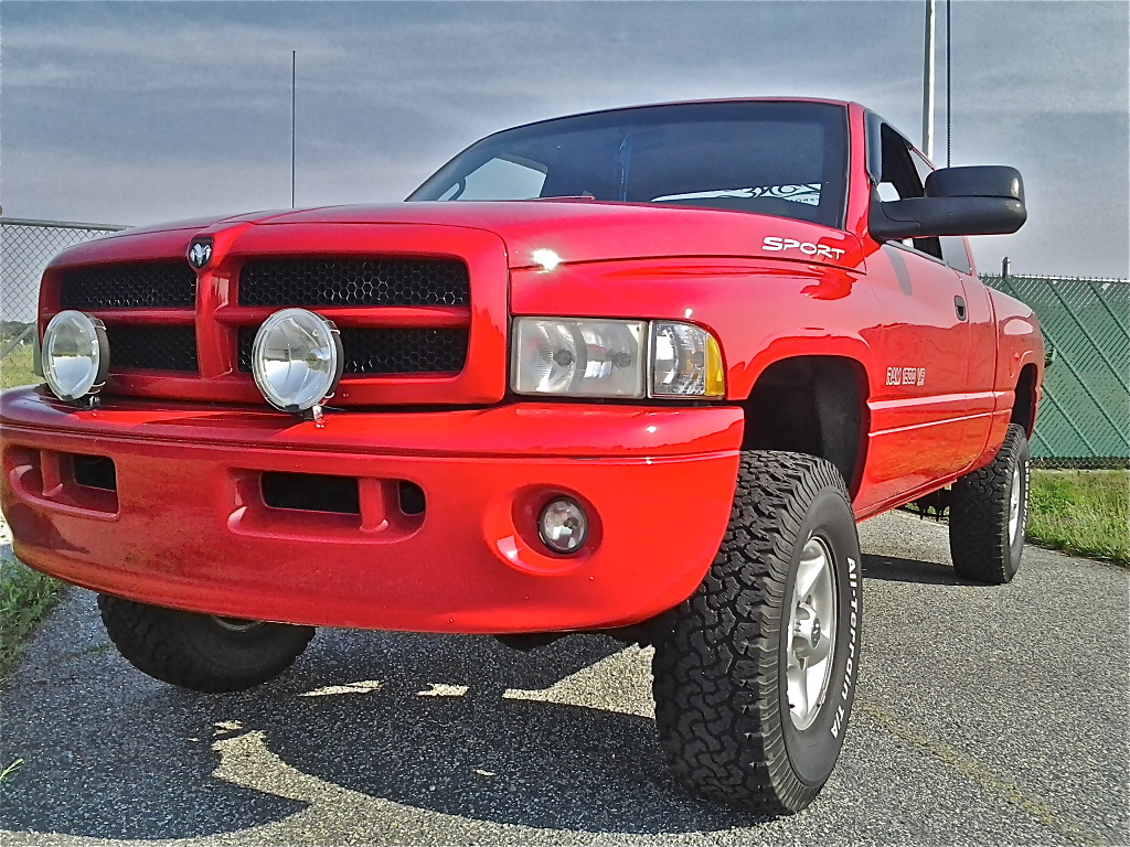

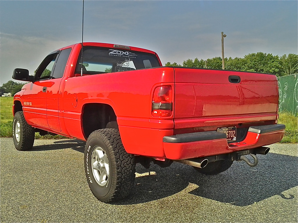

Here's mine. Details in sig. Going with 305s next. Not sure if I want to go with 16s or 17s yet. But most likely 16 inch pro comp steelies on bfg all terrains.

I'm on a Mobile version so it won't show sig's what size tire are your bfg's and how big of a lift do ya have? If I did 305's would I rub?

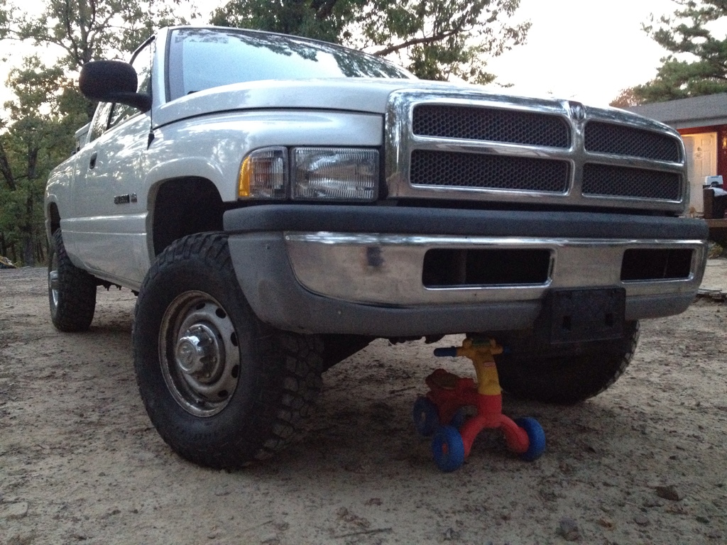

Here is my 2001 2500 2wd with 2" lvl in front and 1" lift in rear. Running factory steel 16" wheel and 255/85/16 BFgoodwrich mudd terrain KM2. Not sure what that equates to but i think they are about 33"

I have 285/75/16 bfgs on a 2.5" zone lift kit (2.5" in front and 2" out back).
Even without a level and the correct backspacing on the wheels you wouldn't rub; so leveled with 305s and wheels with around 4.5" backspacing there would be no rubbing at all.
