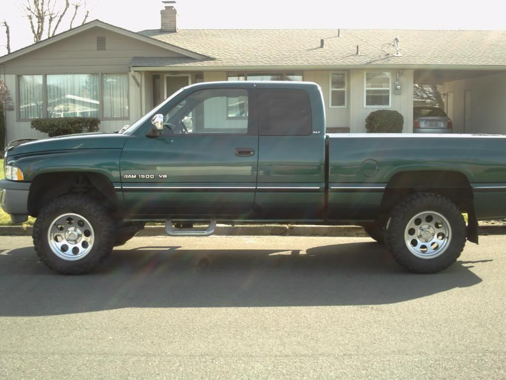

I ran my 33's with stock gearing for a couple years. Its fine unless you are towing. I also have a leveling kit.
How wide are your tires and what size is your rims? Also what size lvling kit did you go with?
