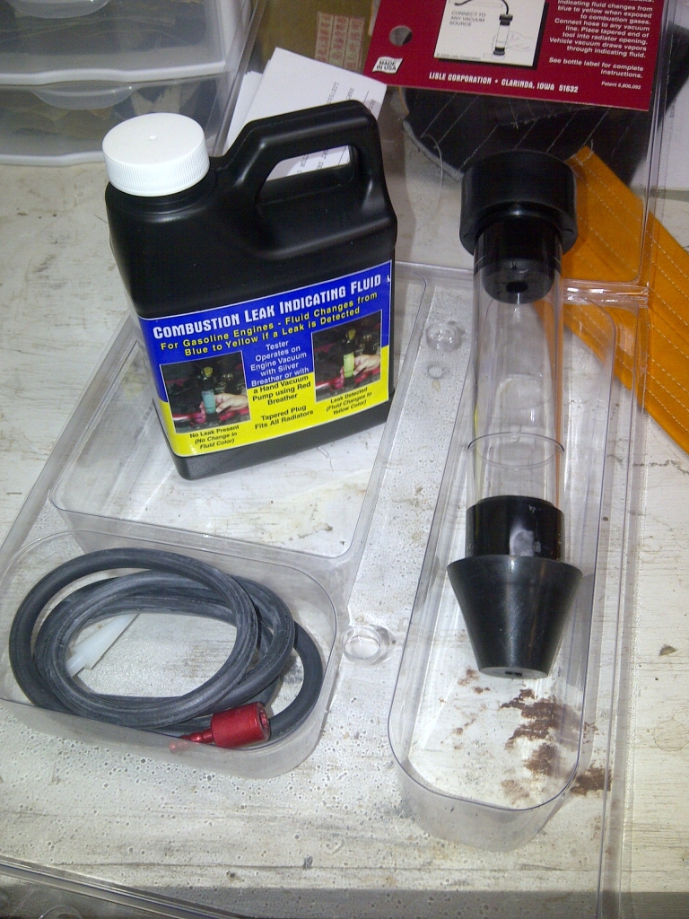

I've seen a few people say that oil can't get into the coolant. What about exhaust from the cylinder leaking into the coolant? That would make the coolant turn to crap wouldn't it?
Again anyone use the Felpro 519SD head gasket?
Old Aug 31, 2012 | 09:13 PM
  #22
gdstock's Avatar
gdstock
Joined: Jul 2011
Posts: 8,259
From: Austin, TX

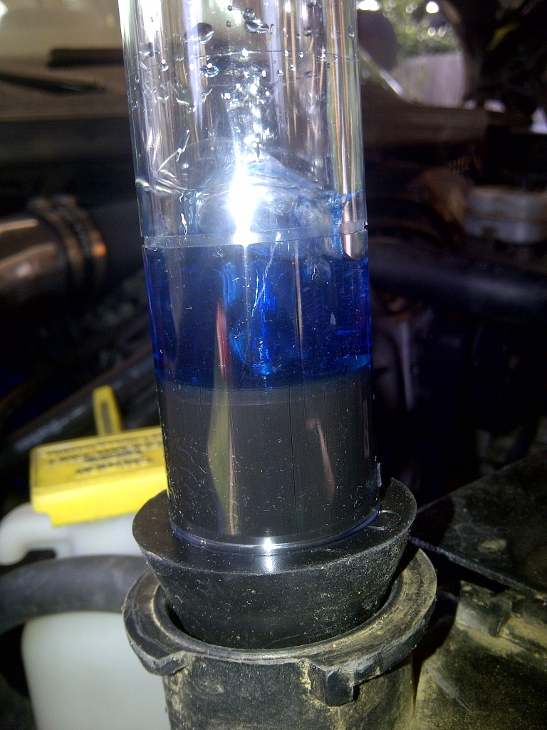

The only good way to test for that is this:
If there are any exhaust gasses, the fluid turns yellow.
