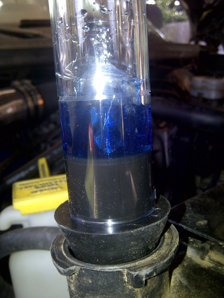

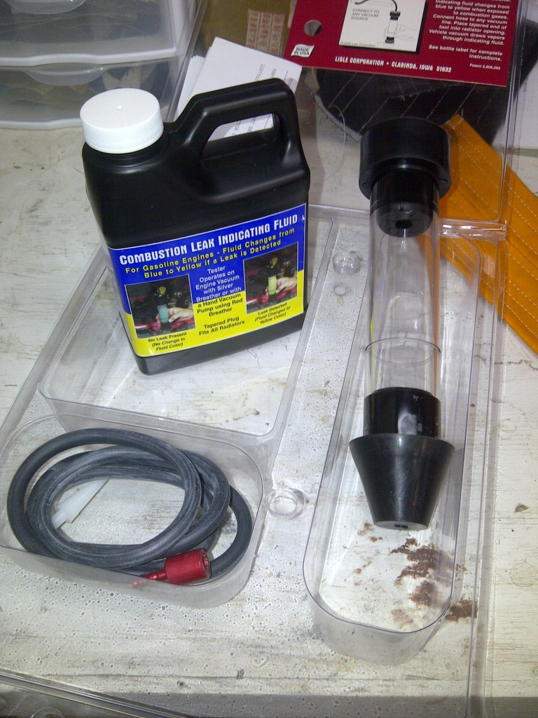

For about $25 you can test for exhaust gasses yourself...
Try NAPA or Tooltopia.com

Ok so I broke down and took it in for a checkup and here's what they found. NOTHING!
Checked the whole electrical system and found wrong. No codes, which I knew because I checked. They did 2 radiator gas tests. One at the Radiator like the one shown above with the blue liquid and another sniffer in the exhaust to detect coolant. Both were negative.
