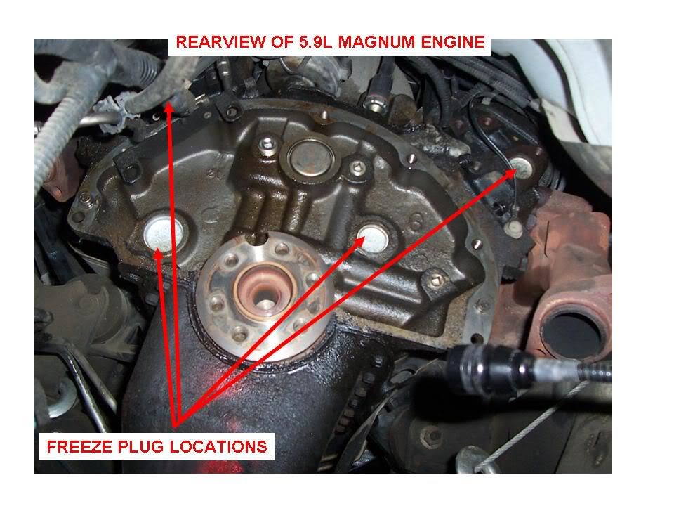

is it leaking at the bell housing? if so and its more clear, it could be a freeze plug thats leaking and your coolant is more water than antifreeze
Old Aug 30, 2012 | 09:59 PM
dhvaughan's Avatar
dhvaughan
Joined: Jul 2006
Posts: 12,204
Likes: 10
From: Gainesville, Ga.
^good call.

it looks like it is further back than the bell housing, i wiped it down and sprayed some degreasser down there im gonna drive it around a lil and see whats going on...and the reason i didnt say coolant before was it doesnt look like it would leak that far back, but that would def. explain why it is a clearer color

...and that would be a real PITA! But most likely what is is and where it is coming from.
