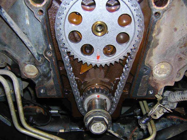

NO NO NO, do not touch the distributor, it will disturb fuel sync of the injectors.
sprockets are key'ed, so they only go back on one way.
simply turn engine to line up the dots (#6 TDC)
then remove and replace sprockets and chain without turning the engine, neither crank nor cam.
it'll look like this, note the keyways.
