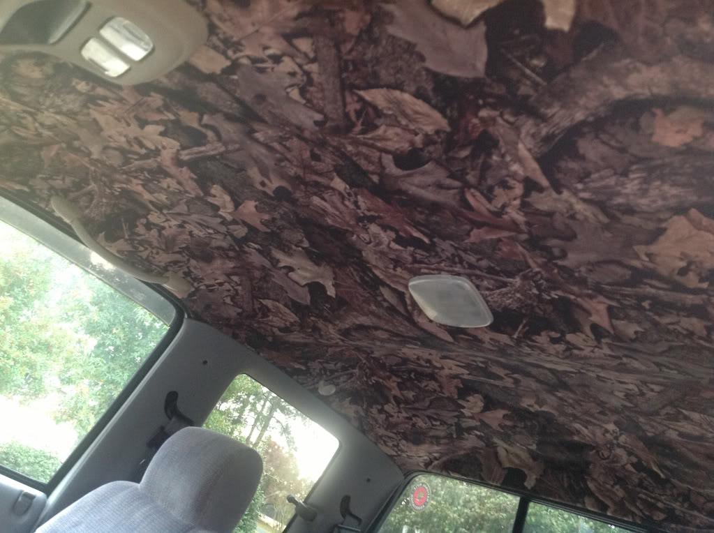

You can do it yourself in a weekend. Yes a good spray adhesive works great. I did mine in camo about 5 years ago. I have a little sagging in the back now, but not that noticeable. Getting the headliner in and out of the truck takes some angling talent, but not impossible. If your going with grey, cut a small piece of the headliner, and take it to color match material. Your gonna pull the old stuff off anyway.
Here is mine
