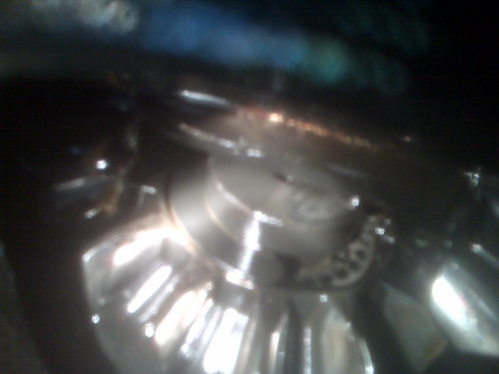

Here is what was on the magnet.

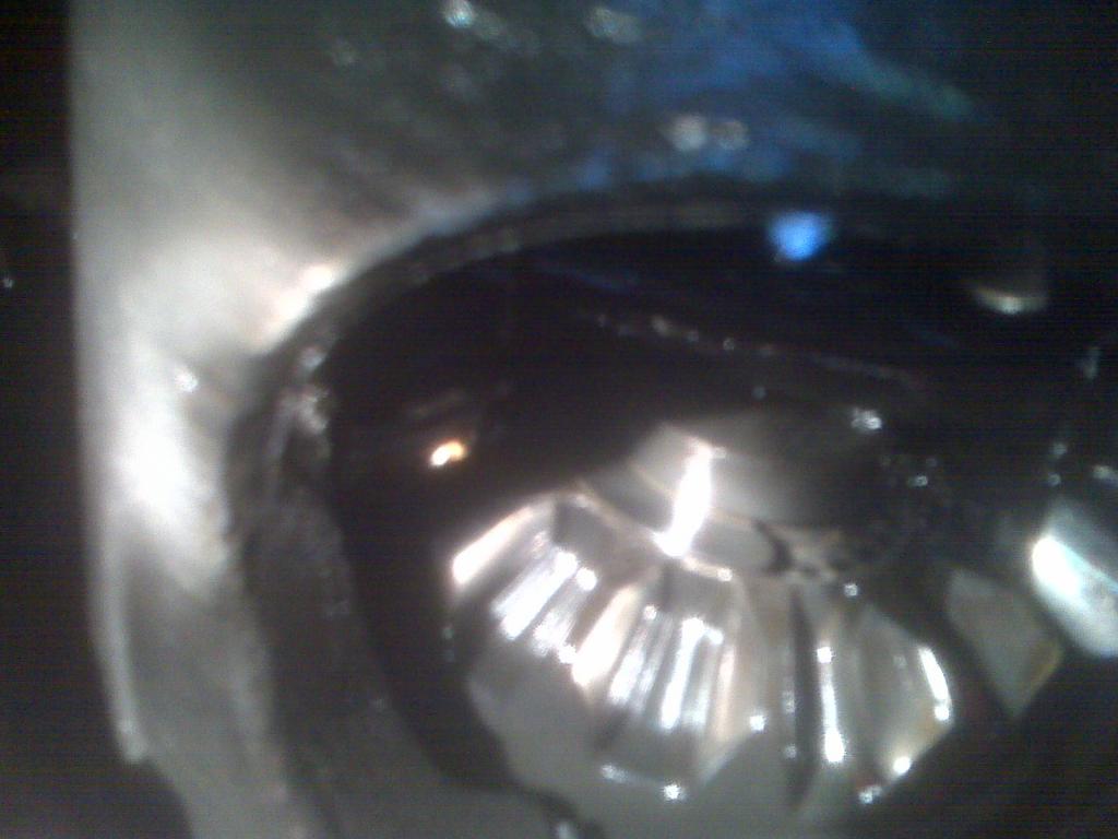

Here is an image of where it broke from.. right there behind the round thing you can see the little teeth in the center; that's where it came from. You see the round thing; then the c clip? looking thing then you can see the teeth as shown in this photo; right there where you see the teeth is where it broke from.

Thanks for the pix, that looks like a 8 3/4 diff or smaller. To be honest I have not taken one of those apart. It looks like there is a internal clutch-pac in the gear, I will go over my parts/service books and see what I can find.

spider gears in carrier, it looks like. the chunk not so bad. its the teeth, if they are getting uneven ware. not centered across the whole tooth it will wear out faster. blown a d35 right out the back of 5.2 grand cherokee modded running in 2wd. no chunks like yours just the uneven ware that lead to failure. probably get a jy axle for less then a carrier and install. just my thoughts if i had to do it again.
