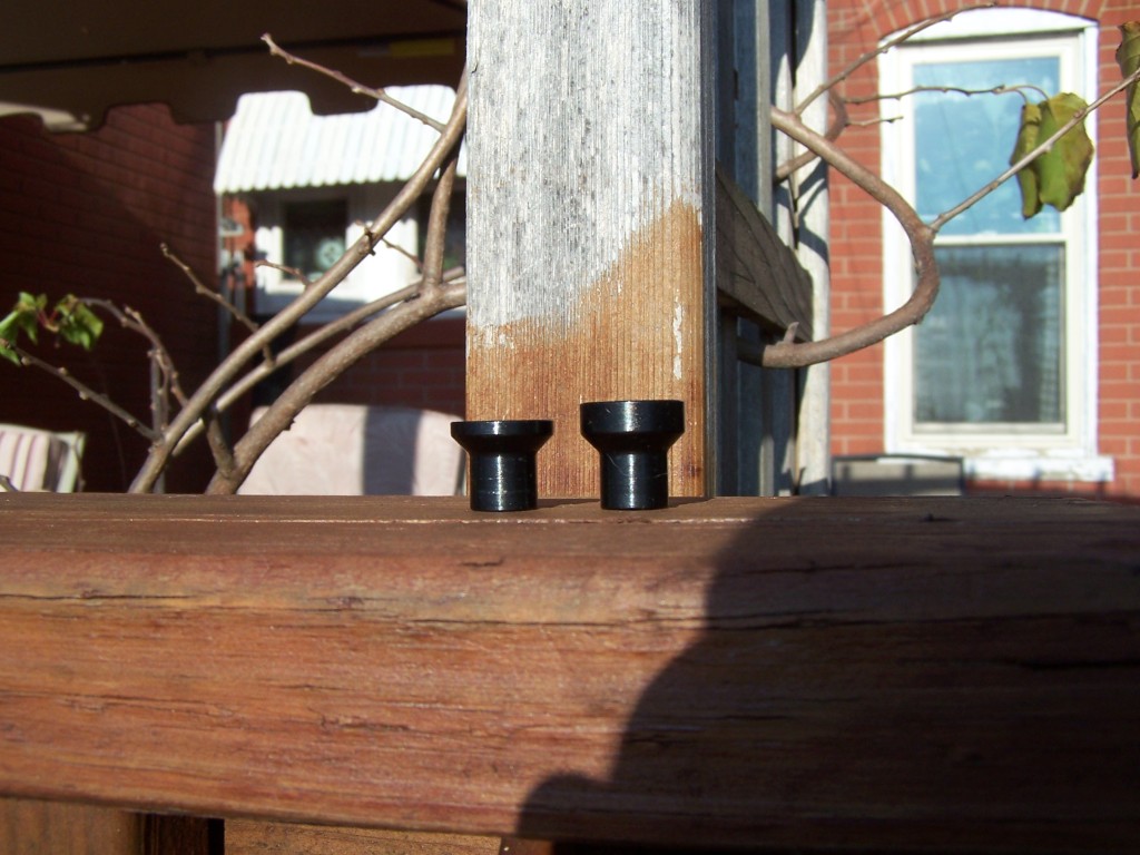

Hello to all! First post & fairly new member here although I have been lurking for some time now gleaning some needed info. for my 96 Dodge Ram. I just wanted to give a FYI note on the H&S 1.7 Rockers for those that are going to purchase soon, I started too install mine last Sunday and ran into one of the rocker spacers that was too short so I had a problem. I did not check them when they first arrived but should have so when you get yours take them out of the bubble wrap and set all in a row to check for equal height. I called H&S and they sent me one priority mail so not a big problem, I really like the performance difference now that they are installed so thanks to those who posted about them and gave me good info. and pictures.

A Dakota owner on another forum ran into that too a couple weeks ago. Except he didn't notice until they were installed and it ran poorly.

That short one in the picture looks like the same one they had in my package.
