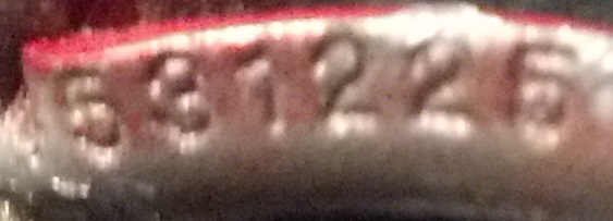

Old Oct 27, 2012 | 11:10 PM
dlallen66's Avatar
dlallen66
Joined: Oct 2012
Posts: 18
This is the number, hard to see the first digit.
Attached Thumbnails 46RE Front seal, Part Number is wrong seal ???-2012-10-27_21-58-34_258.jpg
