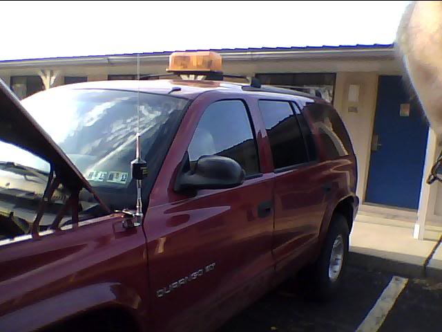

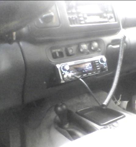

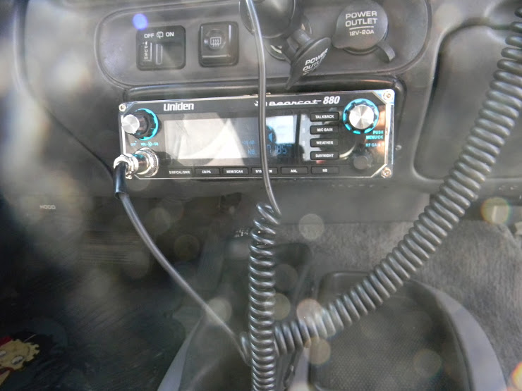

Not sure how close the Rams are to the Durangos but, when i installed mine there was a rubber plug in the drivers side near where the kick panel is that i popped out and ran my wires though...
My Setup:
