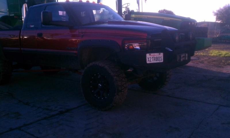

if you are looking for strength, the runell is the strongest thing i have seen, road armor isnt bad by any means, but the runell is built a little heavier, in either case, i would recomend plating the frame at the mounting holes, otherwise a good pull or push in the correct spot can do some major dammage to the fenders and headlights, i speak from expirence
here is mine

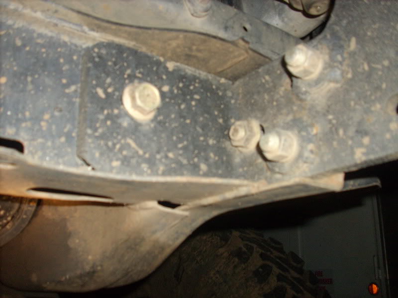

after destroying both my fenders and headlights i added plates to the frame with direct fit holes
and these

I added the plates on the side of the frame and used grade 8 bolts lock washers and nuts

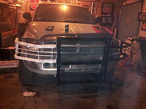

i built my own grillguard out of 3/8 steel and welded a 1/2 plate to the front frame cross member to bolt the winch to. spent about 180 bucks total and imo its stronger and better than any winch bumper your going to find. id recomend building one your self. http://imgur.com/a/HrKCa#4
