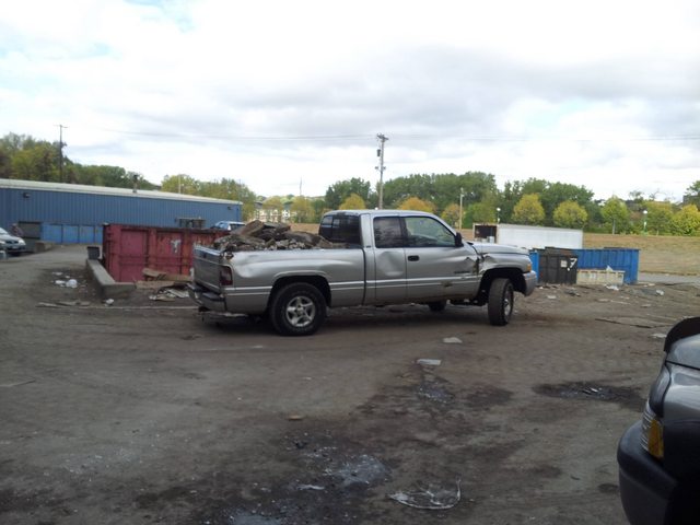

here it is durring that heavy trip: 1500 trans issues-pjqngl.jpg

The overdrive off light comes on when you press the button. (at least, it should) when it comes on of it's own accord, that generally implies your trans is overheating..... the Trans temp light should come on shortly thereafter.....
Whats you fluid level look like? What does the fluid look like? When was the last time the trans was serviced? What makes you think O/D isn't working?

And heavily loaded, driving in OD, is foolish. Need to know how to properly operate vehcile. OD is not made for ehavy loads, pulling trailer, etc. That will toast a tranny pretty quick.

yes this is the same trans that the broken snap ring is from. no repair to the snap ring has been made. i will check the sensors and do a trans flush. the fluid smells burnt and at the last change i put some transX in to help with seals and such. there was no other large parts of metal in the trans pan aside from about a 4" section of a snap ring. as for driving in OD im well aware of what it is for but if the truck refuses to turn off OD then there is nothing more i can do on that front. if she burns up she burns up.
