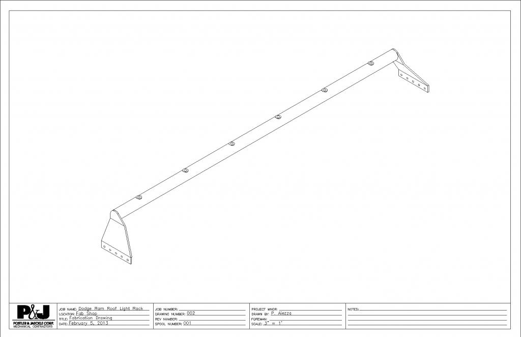

A to-scale CAD drawing I made of a stainless steel light bar to attach to the roof of the cab. Fabrication is in process.
Attached Thumbnails 1500 2wd to 2500 4x4 Conversion PICS! (Long Post)-0820122042.jpg   1500 2wd to 2500 4x4 Conversion PICS! (Long Post)-roofrackplans.jpg
