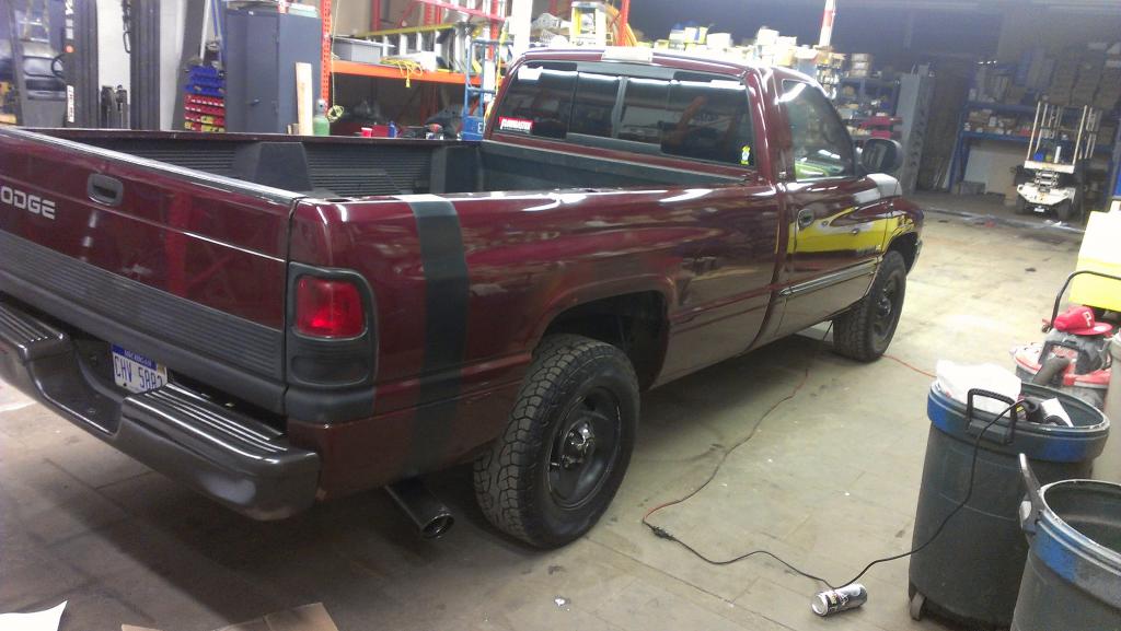

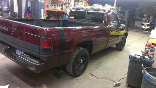

so its been 5000 miles and have not had any problems with the truck trans shifts nice and smooth when im cruising and will throw me back in my seat at wot the only thing i have noticed is that it seems like i have more torque i barley have to hold the brakes to get the wheels spinning and have roasted them past 2nd gear brake torquing i have not dared to go to 3rd as i dont want to destroy a set of 900 dollar hankooks also when theres any wetness on the ground the wheels will break free and **** the person off that was behind me. i alsmost got rear ended pulling out in front of someone (with plenty of space between us) because it was wet and the tires were just spinning. i recently bought a laptop so im going to post some pics of the truck let me know what you guys think
Old Apr 16, 2013 | 08:03 PM
  #26
Kylek321's Avatar
Kylek321
Joined: Feb 2013
Posts: 21
From: Roseville, MI
front end and lights
edit uploading from photobucket because i could only have 2 thumbnails on here

Old Apr 16, 2013 | 08:21 PM
  #27
Kylek321's Avatar
Kylek321
Joined: Feb 2013
Posts: 21
From: Roseville, MI
Attached Thumbnails 2000 ram 1500 trans acting up again after 20000 miles please help-imag0223.jpg   2000 ram 1500 trans acting up again after 20000 miles please help-imag0222.jpg   2000 ram 1500 trans acting up again after 20000 miles please help-imag0221.jpg   2000 ram 1500 trans acting up again after 20000 miles please help-imag0219.jpg   2000 ram 1500 trans acting up again after 20000 miles please help-imag0222.jpg
