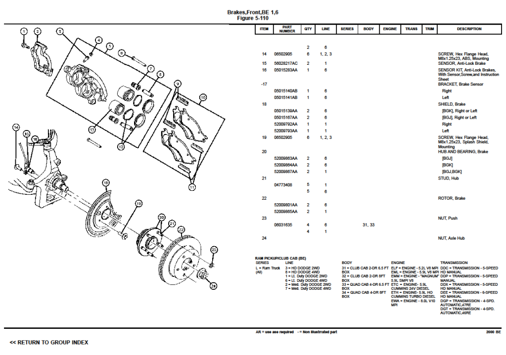

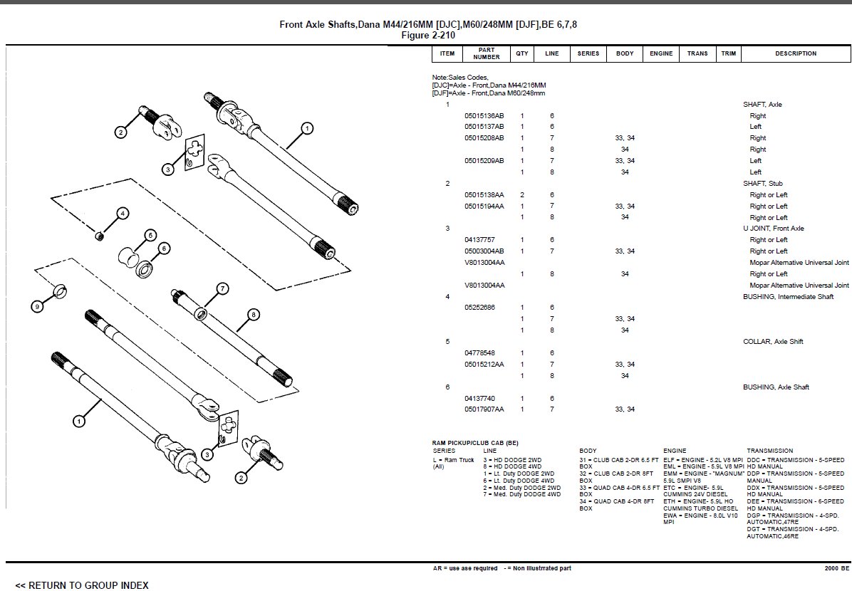

Does it appear on either of these diagrams? (you can obtain the parts manual from the DIY/FAQ forum to download for free)

there are 2 bushings in the passenger side axle. Both are in the CAD opening.
The larger one is a round doughnut with about 1.5 inch OD and 1.0 inch ID. it goes in the drivers side end of the cad to hold the inner axle in place.
the smaller one is a 2 step bushing. it goes between the inner and out axle and sits on the nub on the end of the outer axle. i'd guess this is the one that fell out. you need to pull your axle back out and reinstall or replace the bushing. you may need to remove the CAD to realign the axles, collar, etc.
