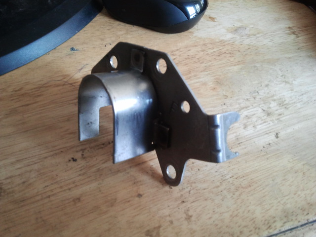

you will also need to grab this from your current transmission to swap over to the 98 trans
it holds the gov solenoid, and transducer in place.
