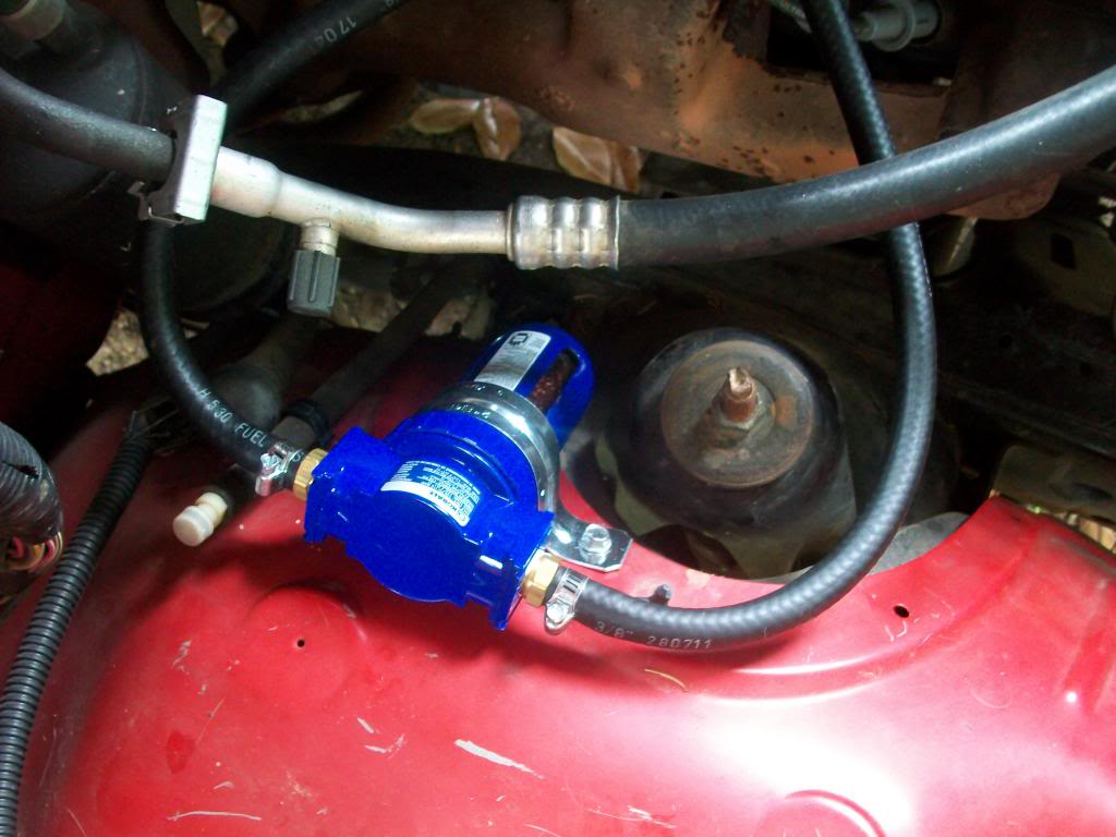

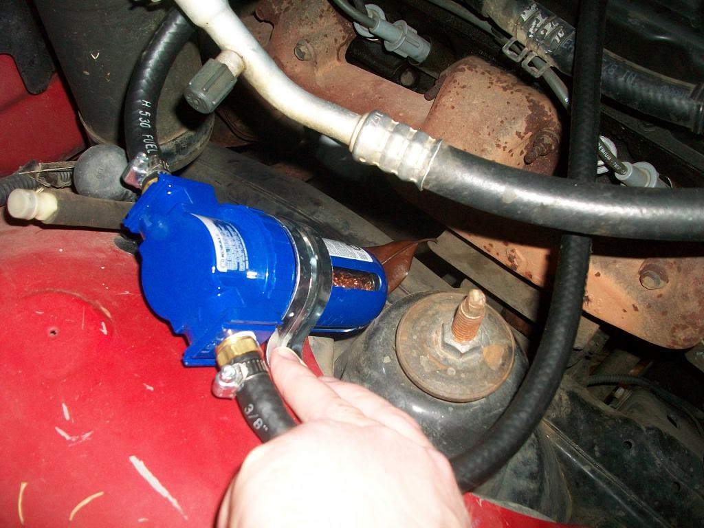

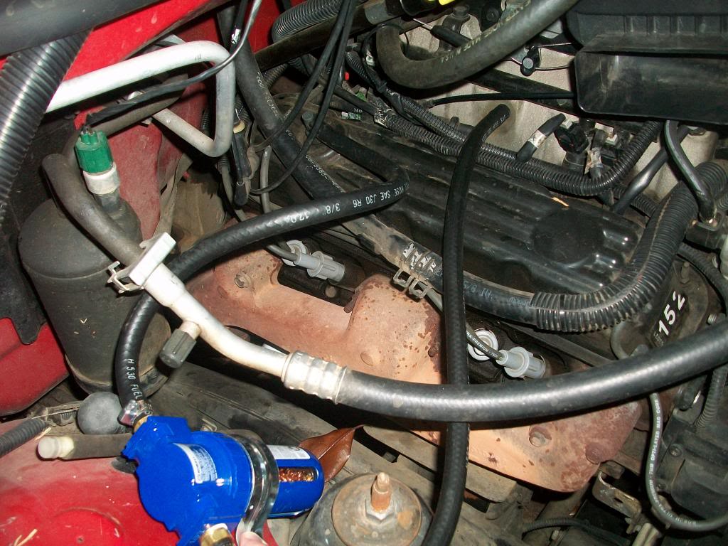

Posts: 8,916
Originally Posted by ChillyPhil
How much did you spend compared to 20 bucks though with all that fancy hose and all?
Separator was $20+ tax at Lowes, about $3 for fittings, used some clamps I had laying around, $10 for 4 feet of hose and $1 for a 3 pack of copper scrubbers. I didn't even use one whole scrubber....I cut it in half. lol
For the mount I used a 2.5 in EMT conduit clamp, that was like $4 for 2 clamps. And I don't remember how much the screws were. They were stainless steel self-drilling. Either way, what I spent, about 40 bucks is still cheaper than $75+ shipping on a real catch can. Besides, it is a good trial of whether or not I needed/wanted one. If this one breaks I might buy a real one.

But you know you want this setup:
