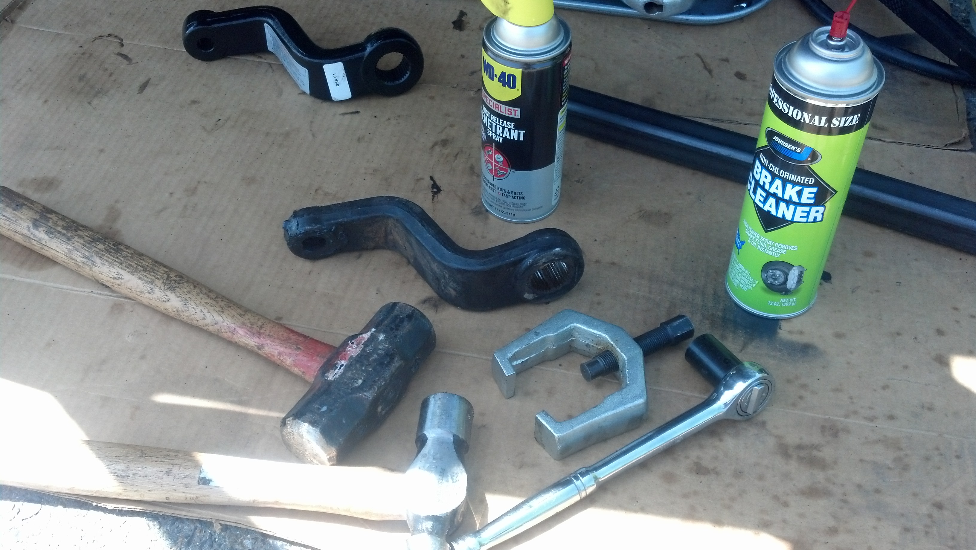

Done!!!
repeated all steps as mentioned previously with one change. A good few hits with the 5lb on top of arm near shaft.

Lol.. If at first you dont succeed, get a bigger hammer. Any sign of gearbox damage?

No...hit it differently next time.
Nope. gearbox is all good. Took it wheelin the next day.
