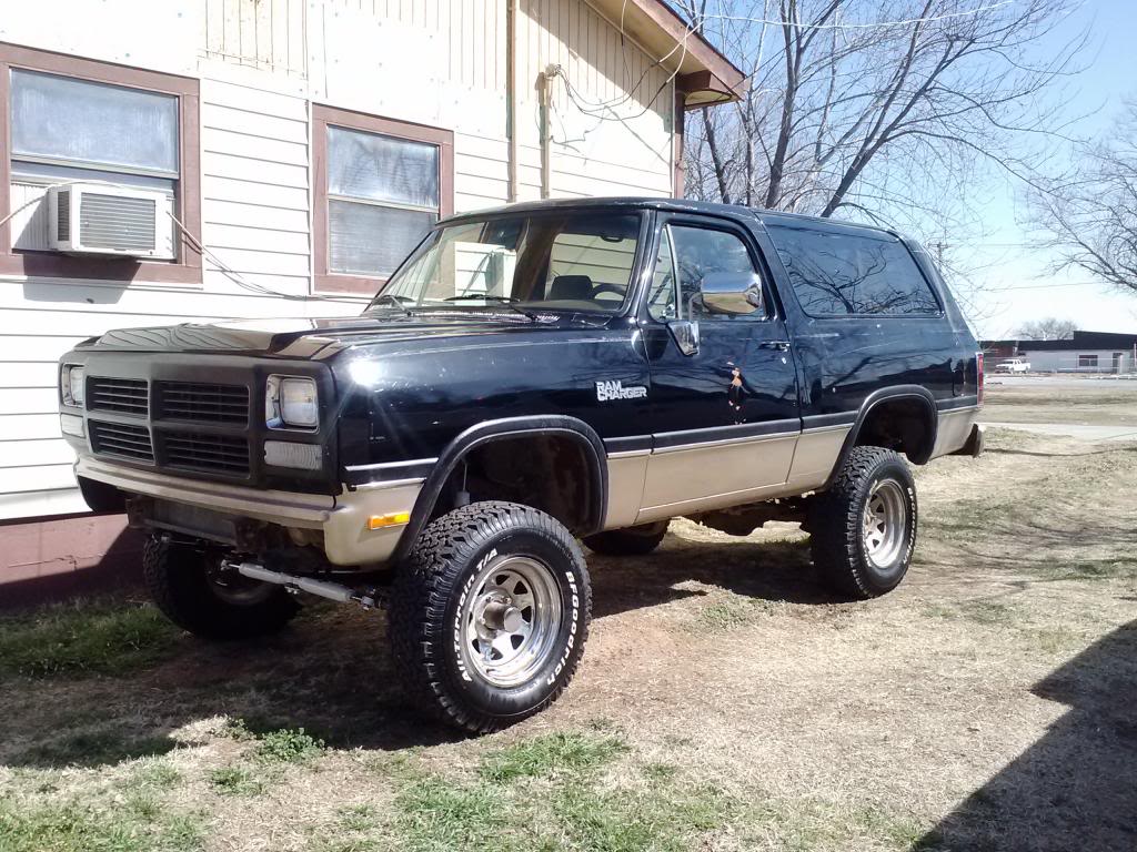

just in case all wanted to see the new toy

What happened to the bumper? lol
That is a nice RC, hows the performance compared to the Ram?

NICE!
I think front bumpers were optional that year.

it looks a lot better with the lift and bumper removed. the valve covers are also looking pretty good.

took the bumper off, i think it looks better and for gettin up some ledges its nice to have out the way. power wise, honestly i think its bout the same as my ram had if not a hair more grunt. i dunno why. yea the valve cover color im also gonna do the diff covers that color, and the bolts black also, and spray the axles black again. should look good.
