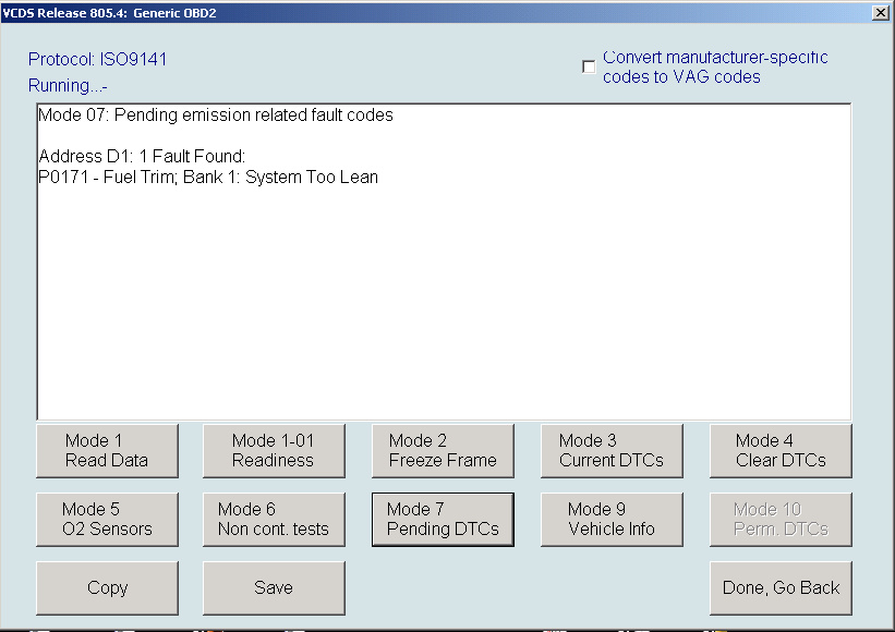

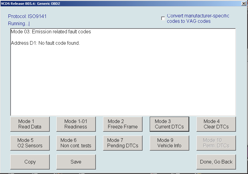

Current codes:
Pending Codes: (p0171 popped up again!)

After letting it warm up, idle fuel trim was bouncing around 0, when I give it some throttle, past about 1500 it will start to jump around, by 3000 its obvious. I'm beginning to think my headers are leaking, I don't hear the tick they made at first, but its possible I crushed the gasket too much and its not sealing properly. I had removed the bolts I used one by one and replaced them with ARP bolts so I could get at them more easily. Could an exhaust leak cause these bouncing trims?
