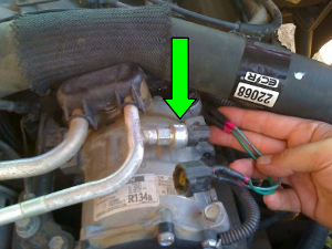

There is an electric sensor on the tube that comes out of the compressor on the high pressure side. The insulation on those wires was badly eroded, they were basically bare wires.. They were probably touching each other and/or the engine block at some point.. I spliced in new wire, covered solder joints with shrink tubing, and put wires inside some plastic protective wire loom..

Knowing that the wiring was bad, could the sensor also be bad as a result? Any suggestions to confirm this or check something else would be most appreciated. I've got a little experience with AC, but so far the solution is not evident from just reading forum posts. (Thanks to all those who comment & help!)

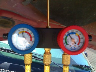

Pic was taken with yellow hose valve open and r134a flowing into system. The low side gauge shows the "danger" pressure level around 60psi.. It actually spiked higher pressure than that as I filled it, all the way up to 80psi on the low side.. When I saw that, I immediately quit - thinking I had overcharged it. I guess I did not wait long enough for system pressure to stabilize.
Now at idle, the compressor is staying engaged, and pressure reads steady 40psi on low side, it is not swinging so wildly.. And it reads 200psi on high side. Road test! :-)
Hopefully using it over the next few days will tell if I have a serious leak..
For other AC newbies reading this - add in the refrigerant like was explained in this thread, and let the system run 2-3 minutes before jumping to conclusions about the pressure measurements. Don't panic like I did.
