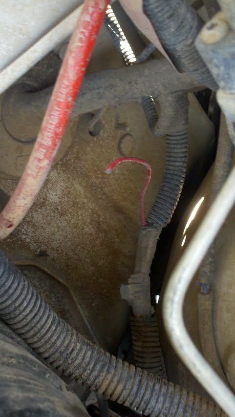

ok so I had some time today to start looking at the wires under my truck starting in the engine bay, found this red wire on the harness that runs down the driver side by the firewall. was hoping you of you dodge gods could help me figure out where it goes or what its for as im not able to find anything.

  #23
Posts: 87,563
Likes: 4,232
Find out where that harness runs off to.

  #24
dhvaughan's Avatar
dhvaughan
Joined: Jul 2006
Posts: 12,204
Likes: 10
From: Gainesville, Ga.
i don't know. it doesn't look like a factory wire, since its outside the harness. also its solid red, like an aftermarket add-on. all the factory wires have color codes.
does it have 12v on it? either hot to battery, or ignition switch, or anything else that's switched.
if i had to guess, i'd say its a hot wire for something the previous owner installed, and then removed when he sold the truck. maybe a remote start, or security, or audio, or running lights.

RamIT1500X's Avatar
RamIT1500X
Joined: Jul 2011
Posts: 53
The harness goes down under the truck. I thought it might have been added on but wasnt sure so ill just secure it and keep looking. Thanks guys
