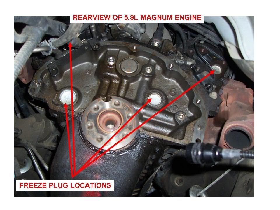

Ok it was tight but was able to get it in there and that is good..... I went a whole day without any more leaks and yesterday I took my truck for a little stroll and when I parked and got something to eat I come out a seen my truck leaking again so I look under it and it seems be be dripping off my trans where it's meets the back of the engine block and can really see where it's coming from any ideas? Is there any plugs there i can't see and might be leaking as well?

yes, there's 2 conveniently located on the back of the block.
here's a pretty complete thread and a pic.
https://dodgeforum.com/forum/2nd-gen...ed-itself.html

I had a leak at the top of the timing cover. Coolant would run down the cover, to the oil pan rail, wick to the back of the motor down the rail, and then drip off...... Clean things off really well, and find out where it is REALLY coming from. Gotta drop the trans, or pull the motor to do those freeze plugs on the back side.... major pain for a 2 dollar part.
