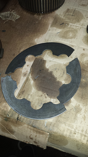

Been working on my trans a few days been cleaning and disassembling as I go didn't really look at much when I started. Well I've gotten through the od unit and the low/reverse stuff and am working my way forward. Got to the rear clutch and found this funny looking plate broken in three.
Anyone got a part number/name or am I going to have to buy online?

I believe that would be This spring.
