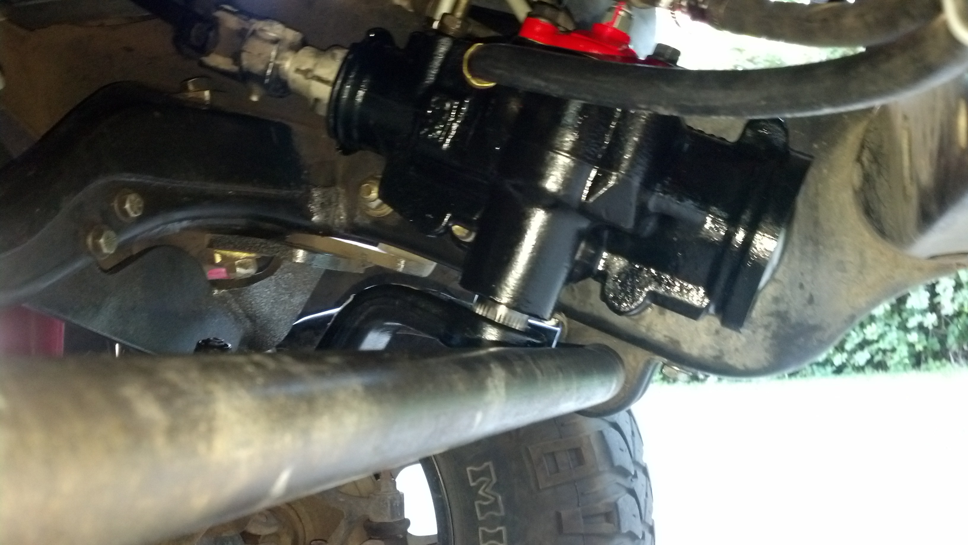

I got one of the cooler's today.
Out with the old... (puny **** cooler)
...in with the new.
I did strip the return fitting. Picked another up at Napa. Just went with Napa PS fluid and will see how this works out.
I used push-lok fitting to join the hoses together with an additional hose clamp for security. Took out for one drive....and indeed this thing is noticeably smoother. So I concur with the OP in this previous thread and others that like the Redhead box.
