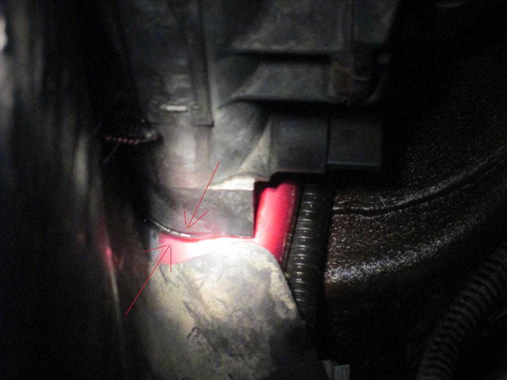

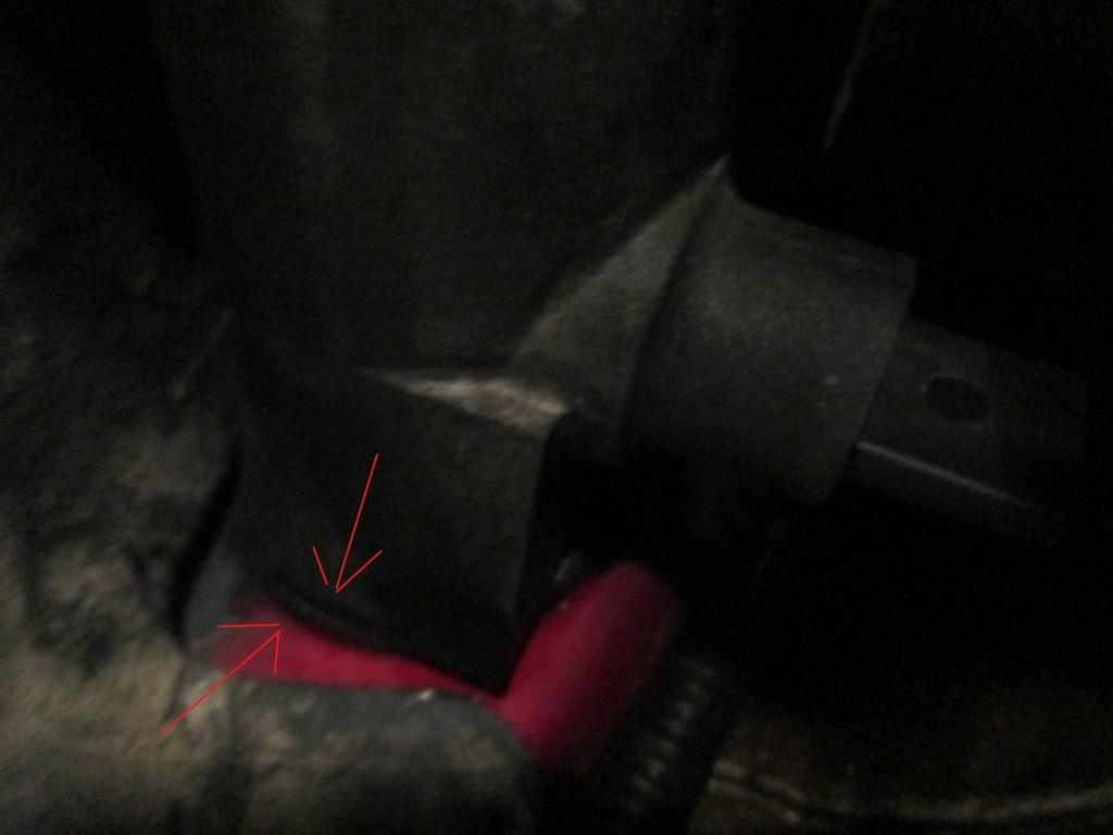

Here's some pictures. I'm sorry that they look bad, I just took them (It's ten here). I drew arrows to the little piece I was talking about.

cracked plastic tank - need to purchase a new radiator!

Looks like I'll be putting a new one in next weekend. Thanks guys

See if you can find a CSF 2969 all-aluminum radiator - it will last you the life of the truck.
