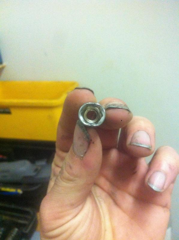

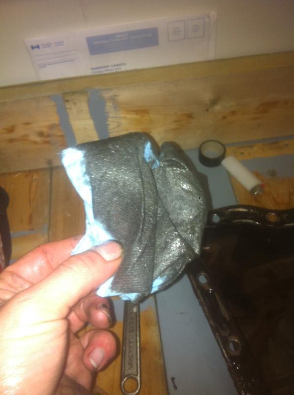

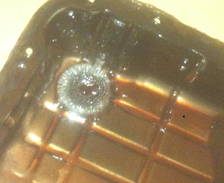

I dropped pan, it had 1/4inch of metal silt. and the magnet looked like a sea urchin. Filter was so full or garbage it couldn't even drain the oil inside it back out the pickup hole. Its minus 15c in the garage with a bit of wind. My truck wont fit all the way in so i cant close the door. not fun.
TIP: Whoever at dodge came up with the square headed bolt on the rear band adjuster should be shot. I spent 2 hours trying to find something that would fit, IF you guys want a cheap easy tool to-get this done. Take a 1/4inch drive 9mm socket and smash it into an egg shape. worked perfectly
