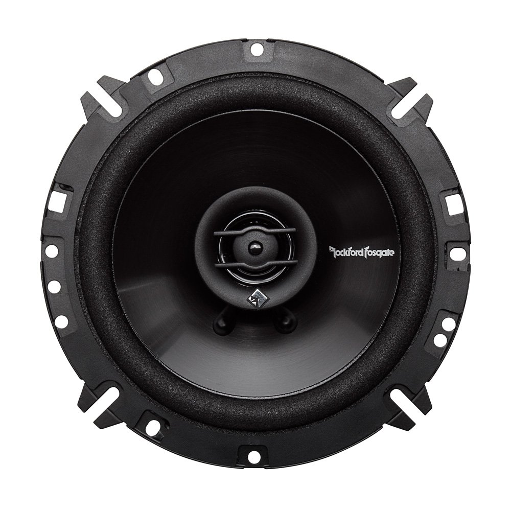

I put 6.5" Rockford-Fosgates in the stock location behind the seat, no problem. The slotted holes work in the factory spot. The only thing you have to do is to clip off the tabs that extend away from the speaker at one corner where the sheet metal interferes.
