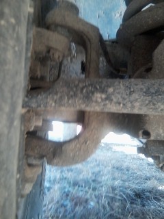

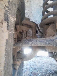

ok so here is a few pics
hope it helps....

It's really hard to tell, I loaded the image to photoshop to try to get a ******* straight edge to it and I think the inner C is bent the knuckle looks OK but that's hard to tell. That's a sketchy conclusion but it's at least 6 degrees of negative camber. That could actually be a bad ball joint too but that's not gonna make the bearing eat itself. Couple things, Are your control arms OK (the stamped metal upper and lower arms that align the axle to the frame). If they are crinkled, bowed out or damaged in ANY way they need to be replaced, this is a given even if you end up replacing the axle itself.
And lastly, before you actually do any of the above...is the rim damaged? Have you tried to have it balanced? A damage rim would certainly wreck a bearing in a hurry. You could give it a visual check by simply having someone slowly roll the truck forward while you lean your head on the fender and watch the lip of the wheel. (I realize how dumb that sounds but your eye is designed to catch movement).
I'm going to load a pic of my inner C on the same side for comparison, I tried to take it from a slightly higher angle with the axle centered in the image.
http://www.blackoperations.biz/pictu...212_205523.jpg
http://www.blackoperations.biz/pictu...212_205825.jpg

If you guys look closely, you'll see that there's a camber adjustable balljoint in the upper. Look at how the upper balljoint's shaft is off center from the upper part. There's your camber issue. Hello mcfly.

Could also be bent. It was in an accident. I didn't even notice, good eye. I only noticed how far off the knuckle was.

I'm honestly amazed I noticed it as well. But look how off center the joint is vs how vertical the shaft is relative to the wheel. Looks offset vs bent.

I agree with these guys its pooched. My Q now is what else is bent, those don't bend that easy. Fwiw if it was my truck it would be off to a frame shop and have it checked out. I would not spend a dime until this is done.
