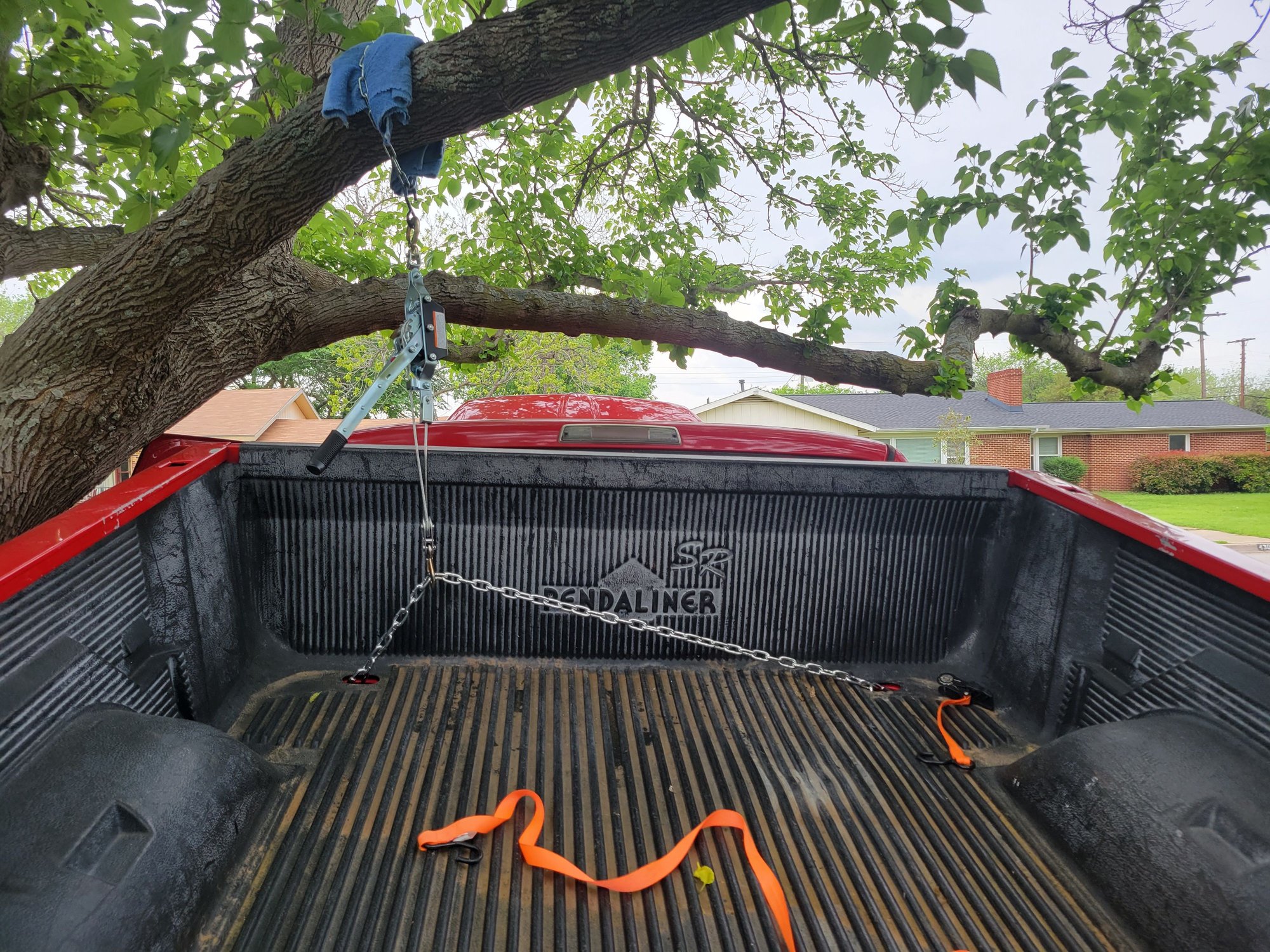

Default Lift the bed
Originally Posted by Flue
I haven't checked pressure, but I'm tossing out worst case scenarios.
If the pressure regulator is going bad and it has to be replaced might as well save headache later and replace fuel pump as well. But would you recommend dropping the tank or lifting the bed?
It was -8 this morning....neither sounds like a very good idea to me right now.
You can get the bed up by yourself with four feet of chain, a come-along, and a sturdy shade tree. Take off all but the two rear bolts, and leave the two rear bolts barely on.
