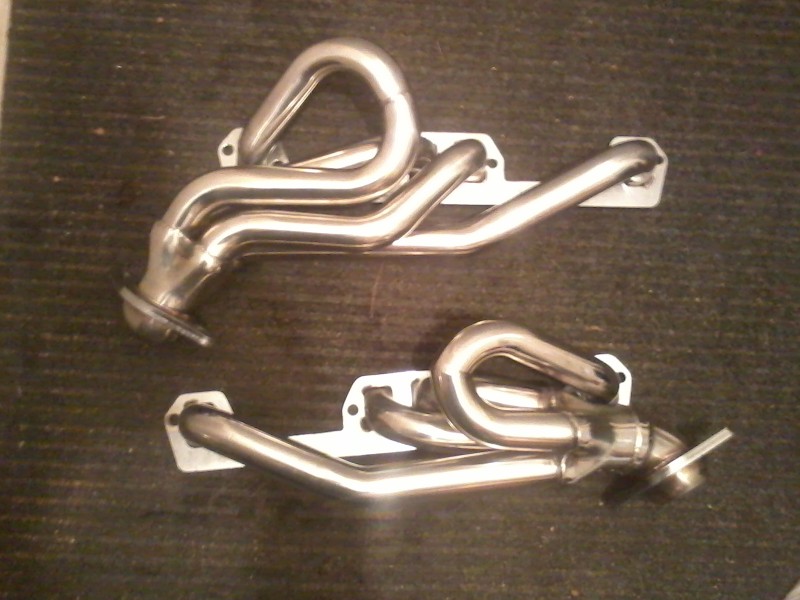

Pretty much stock other than I had the crank, rods, pistons & damper fully balanced. I put in a high volume oil pump and 2 days after I got the motor in I got headers in the mail and em on it. All original internals to the engine, the cam was cleaned & checked professionally. The timing chain is a Comp Cams Double Roller to replace the single roller factory piece. It also has Scorpion Ford 351w/302 1.72 Roller Rockers used with the stock pushrod guides, I didn't get a chance to take pics of those because I was in a hurry to get it done for her, but this motor runs super great with them!.
These are them... & yes the shortys produced a nice low, mid & high range pull to the truck But mid to high was where I noticed most of the gains.
