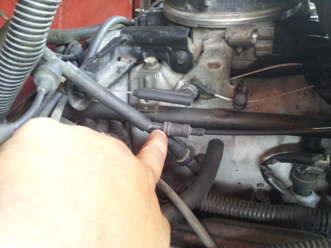

Ok so i tested the fuel pump today. that read at 45(psi) i also noticed that the oil smelled like gas when i took out the dipstick. probably from being flooded maybe? the truck ran today for about 1 to 2 minutes. it ran good. i could rev it up to 4000rpms and everything, then it started sputtering and backfiring after the 2 minutes. seems to me it only likes to run when its cold but then once it warms up it will start backfiring and sputtering. Not sure what else i should check for? i also found a vacuum line that was broke, i got a pic of it in the attachments section if anyone could tell me where it goes...
