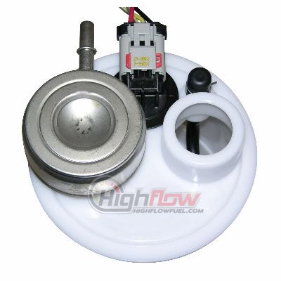

So my truck has been sitting since April. Removed the bed...pain in the rear. I have a few problems. First is the fuel line has a gaping hole on the plastic hose coming from fuel regulator. There is a quick connect that goes into tube and huge hole in the plastic tube
. Second is there is a black rubber cap on fuel pump that has a little ring clamp...kind you squeeze to lift off. the top of it is gone...looks like torn off. It is the little cap on top of the hole in the picture. Note this is not my fuel pump but looks the same.
Third...have tried to get lines everywhere. Dealer does not stock and everyone I have called says don't have 'em. Main reason truck has been sitting. Fourth...there is a wire that goes from driver side frame to center of the rear axle. Wire is cut. Last is the rust under there. Have a KBS frame coating kit going to apply. Landlord threatening to have truck towed...up against the wall. Gotta get the new line...please help.

Dorman makes a fuel line repair kit..... (not that I like them much, but...... ya use what you can find.) Should be able to get one at most any auto parts store. (The listing showed autozone....)
The wire going to the rear diff is the rear wheel speed sensor. Should be two wires.... It's just for the rear wheel anti-lock brakes, that aren't worth spit anyway......
I think that 'hole' there..... the cap for it should have a hose nipple on it. Think that's for the vapor recovery system.
