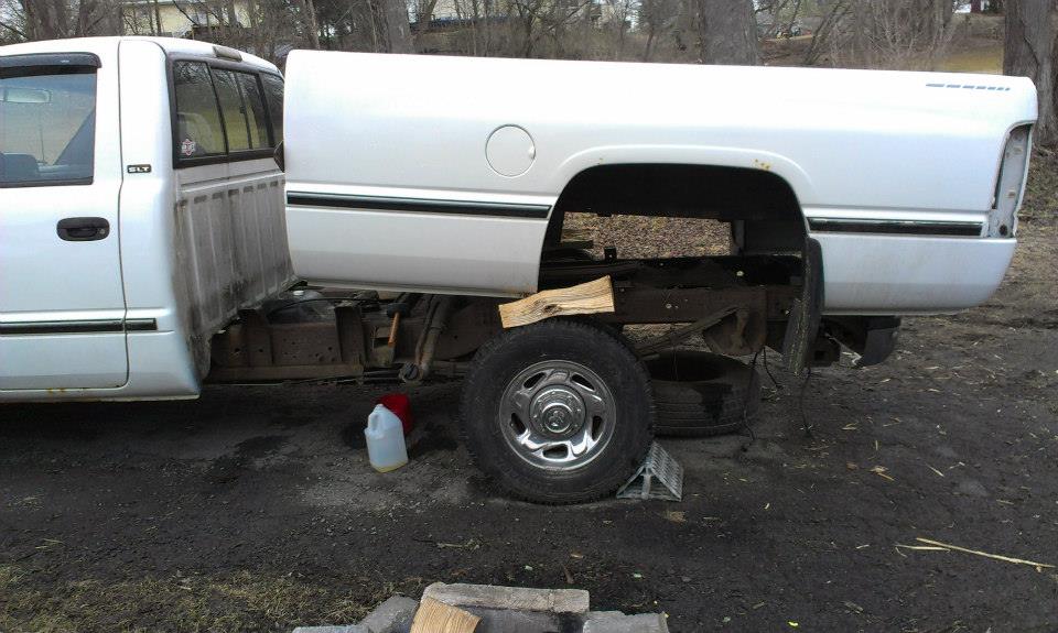

I thought I posted this but I can't see the message. So I am sorry if this is doubled. My question is about the fuel line connection on the fuel pump. It is double sided plastic clip style. The manual says "not serviceable". So now that it is off am I thinking I need to replace the fuel line? Am I missing an o ring or gasket? I had a coughing and stalling engine. I got the bed lifted as the tank is 1/2 full. When my son keyed the ignition nothing happened. I tapped the top of the pump, on the filter, and it started and spewed black colored fuel. It is clear (amber) now. But the connector does not seal...?...Thanks for your time...

Do you think the pump is shot? It used to make noise a few months ago when the key was set to on, before ignition. Now it doesn't, but, as soon as I go to crank the engine the pump comes to life and sprays fuel everywhere...the reason I wonder about the connector failure. I had too many close calls where it outright died, I hate to put fate into this pump. Thanks for the help. I have a local shop that will dispose of the fuel. I plan on pumping it out and cleaning the tank. I lifted the bed instead of trying to drop a tank with about 150 pounds of fuel in it, (I have to work in a driveway and she rests right in the spot you see her in my picture). The good part about the bed being off is that I can run a new brake line without laying on the ground getting rust and dust in my face. Oh and I think my filler neck is shot, perhaps why I may have gunk in my tank...Cheers and have a good weekend.
