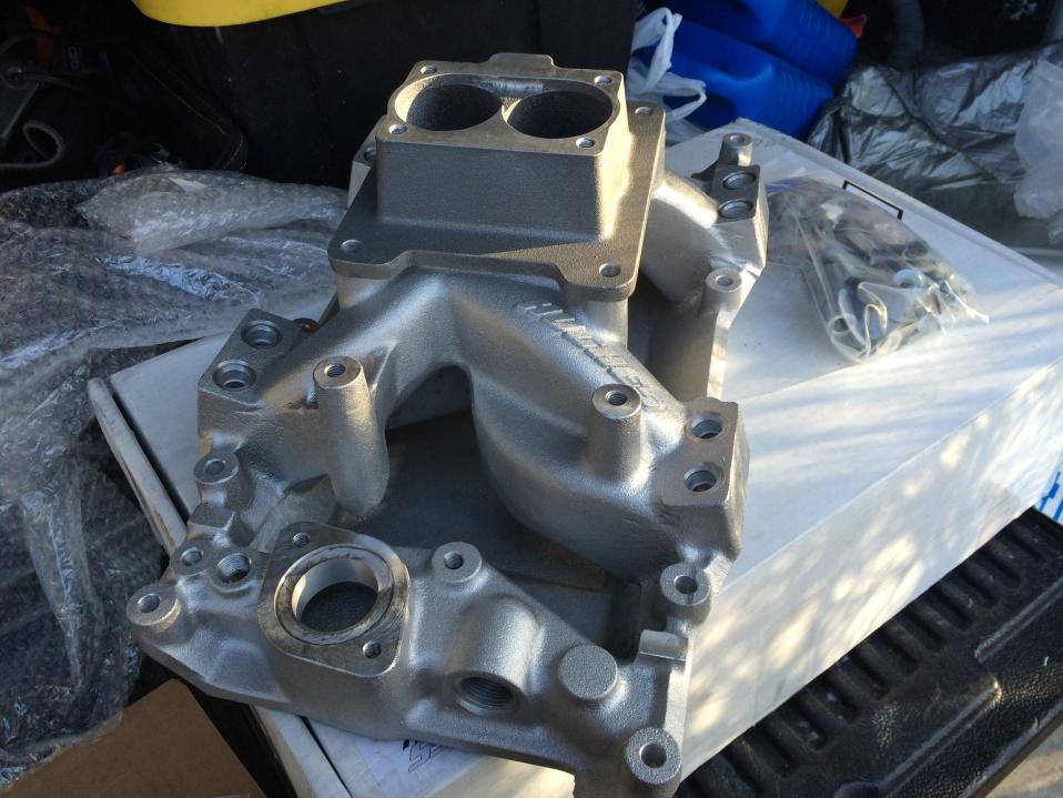

4. The big one... hughes performance airgap intake $600
I couldn't find anything that was definite and solid for a review everyone either said it won't work without doing more performance work or they loved it or they wanted to try it. So I bit the bullet and dropped $600 and promised myself I'd tell guys what I thought about it so if it sucked people would quit buying it. So I installed it 3 days ago...

Here's some of the plus things I didn't consider
The intake is the exact copy of a edelbrock performer air gap intake. Edelbrock actually makes them they just cut the hughes name in rather than there's so I'm familiar with the intake and have used them on other vehicles in the past.
The new intake is smaller and less bulky makes doing a tuneup a breeze with all the room now and any other work around the top of the motor.
The stock air box has about a inch of clearence between the cowl and the box.
These are the downsides and problems I had installing.
It's $600 haha ouch
Some of the machining was poor I used my die grinder and had to smooth some spots and burs on it. The intake was a hair wide and wouldn't fit past the valve covers so I had to cut off about a 1/8th inch off in the 4 spots it was hitting the valve covers die grinder made quick work of it. Took a extra 1/2 hour making sure it was perfect.
The intake is tall so the thick rubber valley end cover gaskets wouldn't fit I removed them and gooped in black RTV which I usually do on intakes anyways.
The hughes instructions had some fails or things that need updated so before you do anything it says make sure and check it for yourself before you follow them over a cliff
They say to cut a hole in your air box for your idle air control valve(IAC) and cut the harness to extend it. Someone on another page told me to drill and tap it into the intake adapter under the throttle body. I was able to screw it into the extra passenger side vacuum port and plug the harness in no mods needed.
The intake looks so awesome and sexy sitting there and they send these chincy brackets that you are support to "bolt up" the injector rails to holding them in place. I spent almost a hour getting these stupid things bent and tweaked and bending my rail brackets gently so the injectors seated right square and center. And it looks crappy when your done you'd think for $600 you'd get something dressier haha.
The worst part of the instruction fails is they say to cut the new fuel lines between the two rails shorter to 5 13/16.... So I did..... Before checking the measurement..... Luckily I had a scrap piece in my tool box but it doesn't quiet hold so I have a leak.Im going to get the high pressure crimp style clamps and redo it this weekend but I don't trust just heating it and sliding it over.
Some of the bolts were short for my liking going into aluminum and there were a couple washers missing so I used some more of my toolbox collections and found some 5/16 hardware.
Tips that helped me:
I saw someone else do this so I tried and it worked flawlessly and helped a lot.
I took 4 old intake bolts (new ones come with kit) and cut the head off then cut slots in them to take them out with a flathead so that when I put the intake on these bolts would prevent the intake gasket from slipping and having a leak. The slots are so if u cant get them out then use the flathead on them
The nylon line for the fuel rail was suppose to just be heated with boiling water then slide on from previous experience I've found boiling oil in a coffee can with a torch works better the oil gets hotter than water and holds the heat longer just be careful u will only need to put the line in for a second it will melt otherwise.
It's $600 haha ouch

Here a link to my album I put up from the install.
https://dodgeforum.com/forum/members...all-21145.html
