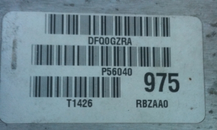

I bought a used PCM off of a 1996 4x4 sport w/ 5.9L. But I noticed there was a difference in the serial information. What is a "T1666?" Mine is the T1426 guy. Are they different considering the 4x4 is just that and mine is a 2 wheel drive?
Attached Thumbnails HELP!!!! 1996 5.9L 2WD 1500 problems :-(-t1666.jpg   HELP!!!! 1996 5.9L 2WD 1500 problems :-(-t1426.jpg
Old Jul 6, 2014 | 11:40 AM
Posts: 87,563
Likes: 4,232
Probably different programming. The 96 PCM doesn't care about 4x4 or not. It doesn't have a clue how many drive wheels you have. Plug it in, give it a shot.
