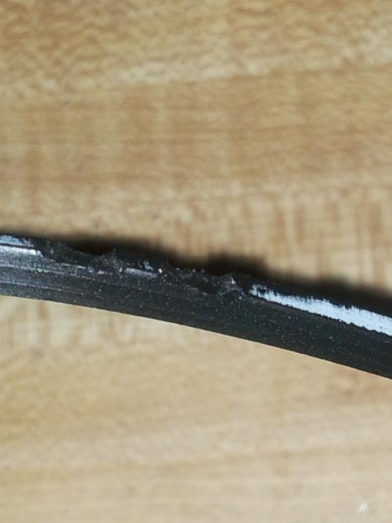

I do paint & bodywork for a living & have multipul slide hammers non of them have a heae that will hold a bolt that big..anyways I was finally able to get it out & after looking it seems this gasket is bad Im wondering / hoping this is the problem.What ya think?

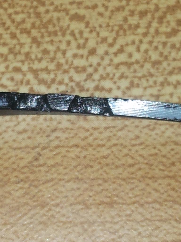

upon pulling the.o ring.I found this..hopefully after.installing new seals&obrings itll be ok.Name:  20140708_033414.jpg
