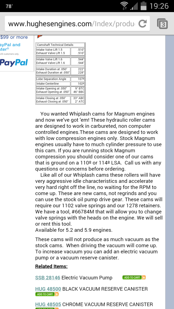

I'm going to be putting a cam in my truck next. I am running the MOPAR m1 4 barrel intake and a quickfuel hr600 carb.
I'm looking at the whiplash cam from Hughes but It says that you shouldn't run it in a factory magnum bottom end because compression is too high. Why is that? I didn't think a cam had anything to do with that.
Specs on the cam are
Lift- int .544/exh .544
Duration- int 222/exh 228
Lobe seperation- 107
Intake centerline- 102
I know I'll need valve springs, I'm going to run 1.6 roller rockers, will I need different pushrods?

Oooo, thats gonna be a lopey cam. Huge lift, relatively long duration, tight lob separation. That cam is actually going to WANT higher compression. Could it be they don't recommend a stock bottom end, due to a LACK of compression? Link to the cam on the Hughes site?
May need different pushrods.... I think I would replace the stockers in any event, with some nice, hardened pieces... that's a lotta lift, and is probably going to also have some pretty serious spring pressures.

cam wont work. need to be carbed and non computer controlled. you also need lower compression...

I see that now... still wont work due to too high of compression...
Why won't it work?

Read this...

i know what it says, that's why im asking. how does it produce too much cylinder pressure? I know the short lobe separation plays a part in it but its the same as a comp thumpr and they don't say anything about causing too much cylinder pressure, ive seen them run in stock motors without issues. I was just trying to figure out why it wont work
