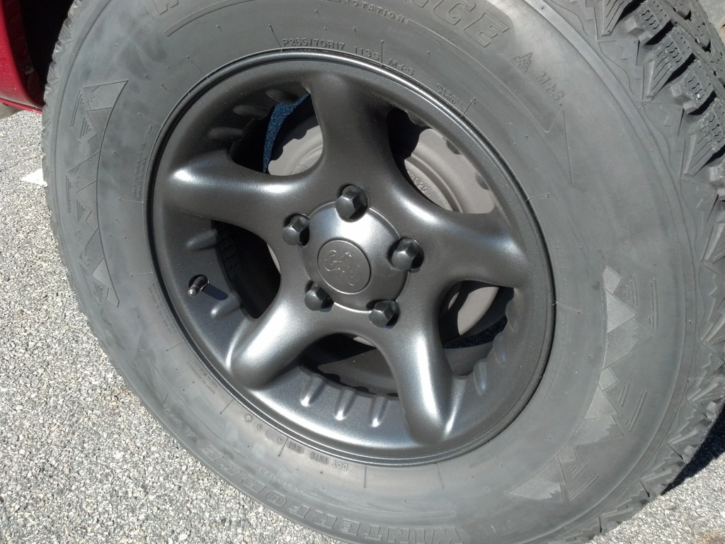

Here's my 2001 (not ORE) rims painted with plastidip over a year ago. Washed rims with dawn, used index cards around the rim to mask off the tire and put down five coats. No peeling or fading. I like it.

I'll give a +1 on the plastidip option...I know a bunch of people that have used it and have nothing but good things to say...I might even do it to my offroad edition rims if I ever find the extra time
