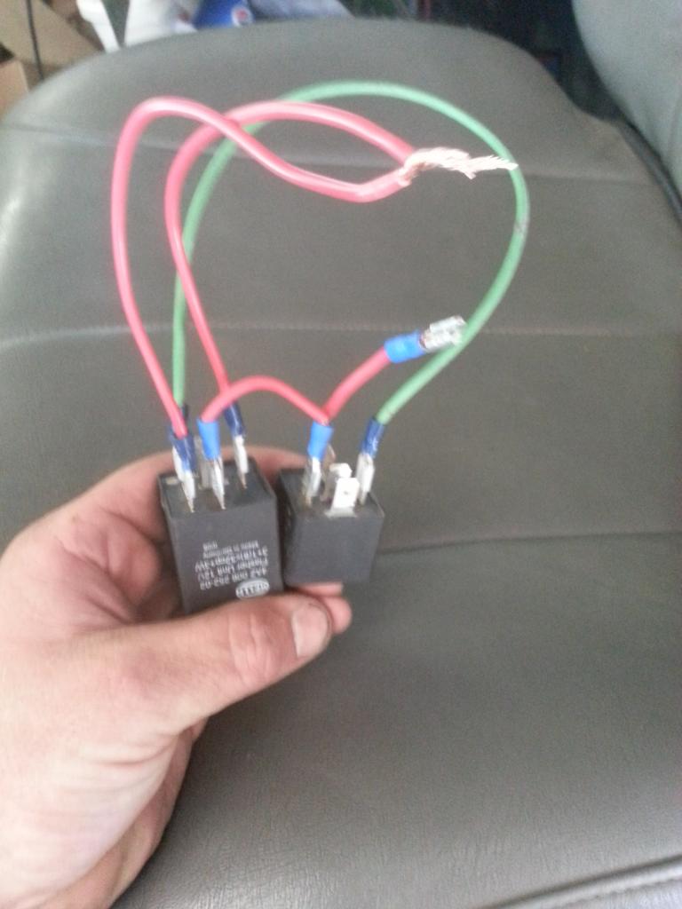

well.... maby i wont need the reprogram if this works....
after thinking a bit, with a diesel program/ecm i will have to change my custom damper for a factory one if i did that, i have been through multipal relay wirings and resistors tying to get this cam sensor and ASD relay to play nice, but its been nothing but a pain
i studied some more theroies of operation and lots of forum posts, and built this, its an electronic Hella flasher unit hooked to a relay, beench test works great, so i am going to install inplace of the cam sensor and see if it will do the trick
