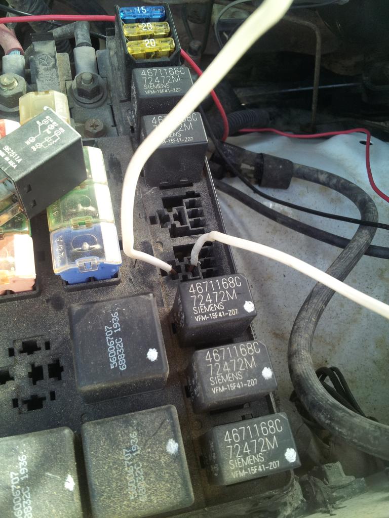

Step 4: Remove the cover for your relay box, it's located by your battery. Find the Fuel Relay and remove it. Take your wire and put it in where the 85 and 86 pins go for the relay. Be very careful not to come touch the metal part of the wire, I'm not responsible for you harming yourself, your truck or anything/anyone else. Doing this will power your fuel pump and you'll hear gasoline filling your fuel can.

You'll want to stick around your gas can and check on it every few minutes to see how it's pumping, make sure you don't overfill your can. If you do, pull the fire from the relay box, get another gas can and put the wire back in. The purpose of this is to make the fuel tank lighter when raising and lowering it.

Is the wire just 1 wire with both ends in the relay? And which gauge wire did you use/would you recommend?

Stewie, Yes, that's just 1 wire with both ends in the relay socket. I used a solid 14 gauge wire. It fit pretty well. I had gotten the wire from an old piece of 14-2 wire I had sitting around.

Just pop the cover off the relay and wedge a pocket screwdriver in it.
