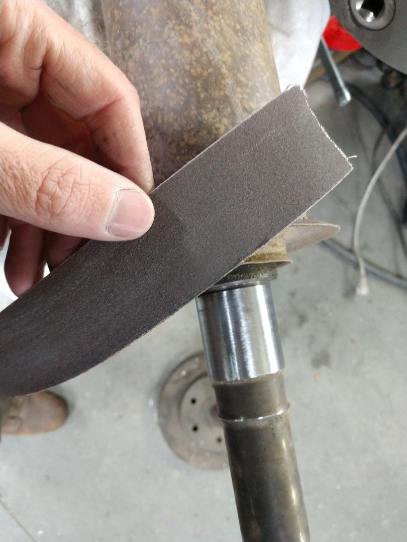

Now, when reinstalling a press fit, preparation is the key (I'm a machinist so us types do a fair bit with press fits....). Still, it's nothing common sense doesn't dictate. First, clean up the shaft with some emery paper - I used some 180 grit strips I keep for the lathe. Second, remove any burs both on the male and female parts. The press fit ring in the Precision kit had some bad burs and I made sure to get rid of those (this presses on AFTER you've slid the bearing onto the shaft). Third, lube all surfaces with a thin film of your favorite grease.

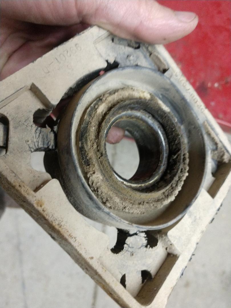

Finally, (last post I promise) I replaced the OEM bearing not because the bearing itself had failed but the rubber surround was letting go. I give 'em props for a design that probably excels at reducing NVH (at least on paper), but with only a few points of contact in rubber "fingers" it's destined to fail sooner than a solid rubber block. Still, it lasted from 1999 to early 2020 so it's not horrible.
