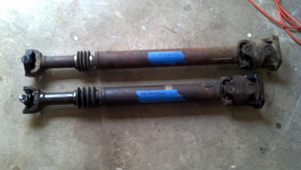

Some front driveshaft info depends on wheelbase , year, tranny.
94-02 1500 two opt's
27.5
33.5
The two 1500 front driveshafts.
94-02 2500 few more opt's
27 1/8th
27 9/16ths
28 9/16ths
29 1/8th
32 13/16ths
33.5
