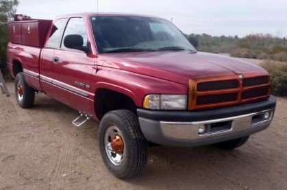

Notice Dupli-color copper plate spray paint on grill and hubs. 1.5 kits.
